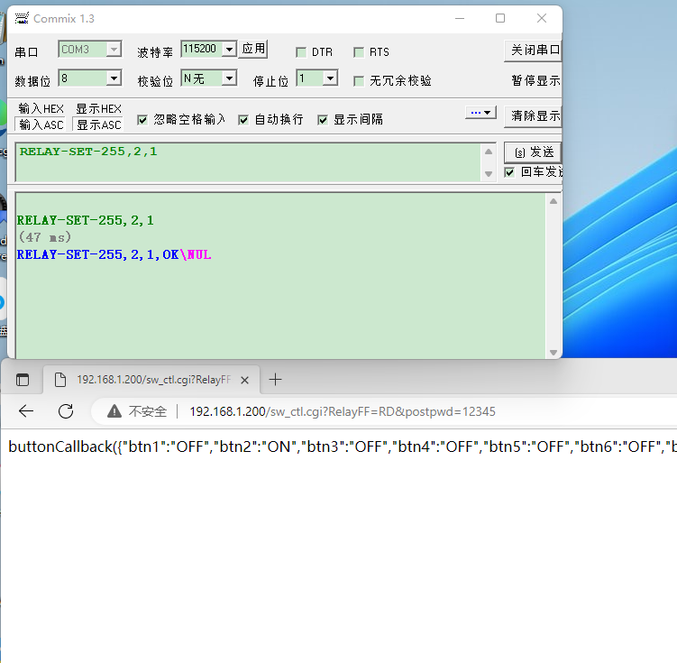

I'm using H32B with switch terminal board. I connected a push button/switch to the switch terminal board. It is controlling perfectly the relay.
The problem/bug/issue I have is the following:
- Initial status all relays off. I query the relay status over HTTP with "http://192.168.1.9/sw_ctl.cgi?RelayFF=RD&postpwd=<myversecurepw>". It shows all relays off.
- I push the button to turn on relay on. The relay turns on.
- Then I query the relay status again with the same HTTP command but still shows off!!! but the relay is physically ON.
- If I change the relay status over HTTP command (ON/OFF) and query again over HTTP command as above then it is reporting the relay status properly over the HTTP command.
I can also reproduce the same with any of the relay outputs.
Can you have a look on this? Maybe a firmware bug?
thanks.
