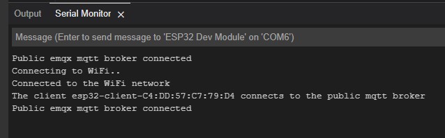

[pièce jointe=2033] bonjour je recherche un code .ino pour communiquer avec home assistant (sans tasmota ni esphome)
j'ai essayé celui ci mais je n'ai rien qui s'affiche dans le broker ?
[pièce jointe=2034]
[pièce jointe=2035]

I am looking for an .ino code to communicate with home assistant (without tasmota or esphome)
I tried this one but I have nothing that appears in the broker?

I created a program to manage my heating and I would like to upload the data in home assistant
I don't want to install kcs or espeasy or other firmware
 is it possible to upload the data in mqtt?

(03-04-2023, 12:36 PM)admin Wrote: ok, you can write your own arduino mqtt code to ESP32.
I looked for a sample code but I couldn't find it.
the code above, if I enter my ip address of my mqtt server and user, psw I should be able to add them in home assistant?
