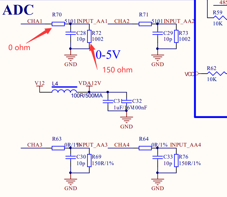

Is it possible to add an example for measuring 4-20mA on AI 3-4? Is it possible to connect a 24V sensor to this input? Thanks
esphome config line as same as measuring dc 0-5v sensor. if you connect with 4-20mA signal to board, also will convert "current" to "voltage" value.
now board input level MAX is dc12v , if you want to use 24v sensor, you can convert to dc12v then connect to digital input port.
Can you maby assist me how to connect a 4-20ma pressure sensor to the unit?
Sensor info
Supply 9-36vdc
Output 4-20ma
Range 0-5bar
the default circuit is use for analog input 0-5v. if you want to test with 4-20mA, need replace two resistance value. such as here is sample of ADC1, replace R70=0 ohm R72=150 ohm
Sso for the A6 model all Analogue inputs are 0-5v defaut. can I replace all 4 inputs reaiators to use 4 x 4-20ma sensors?
yes, you are right.
Do you have models that can use 4-20ma sensors without modifications
