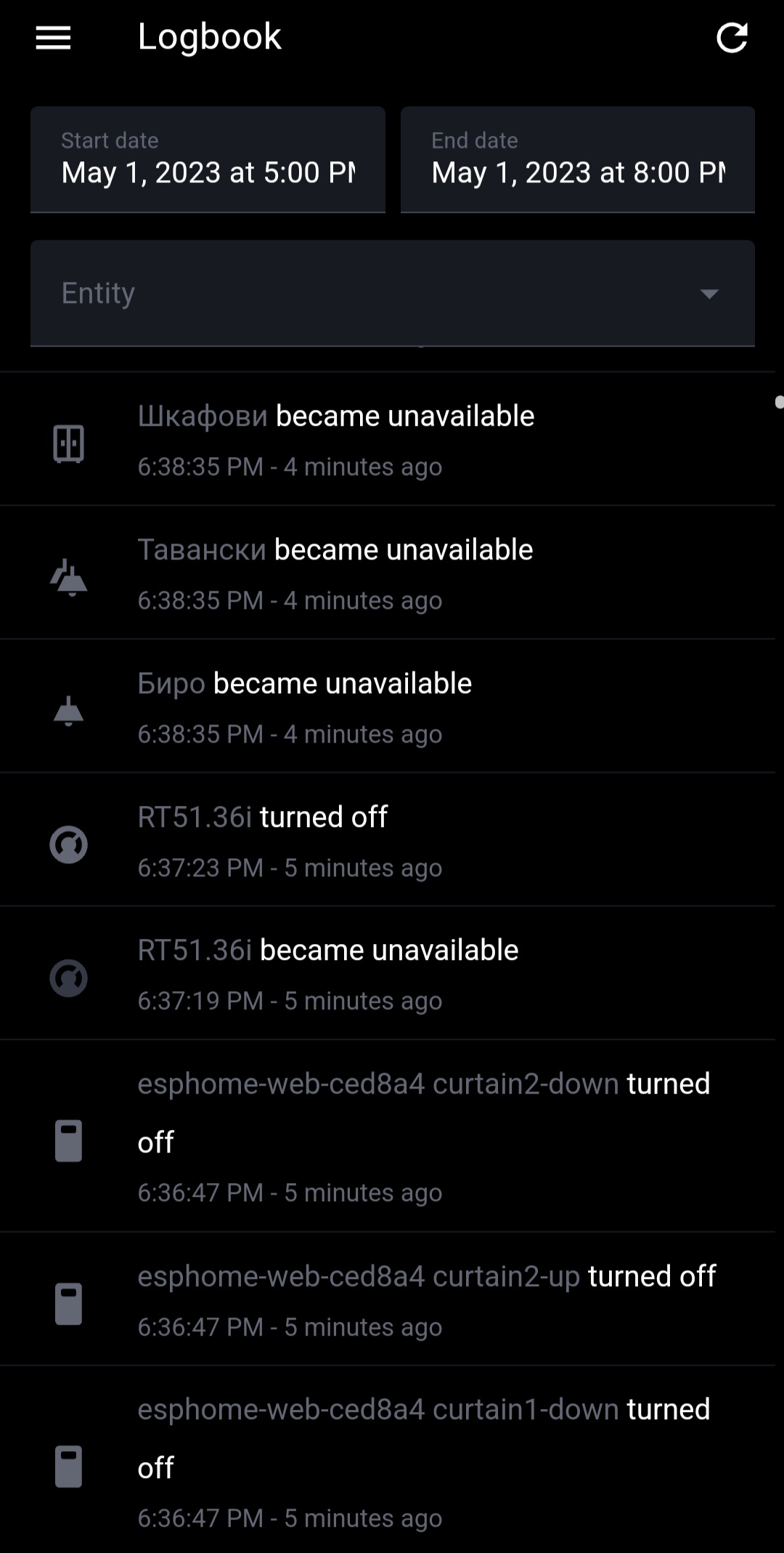

Hello friends,
I am using A8S card for controlling the lights across Home Assistant. The card is connected with wifi. For some reason the card in HA becomes offline and all relays turns off. I don't know the reason why the device is going offline, maybe the problem is wifi. How can I set in HA to keep to state if is it possible.
Here is the yaml file.
Thanks a lot
.txt   esphome-web-ced8a4.txt (Size: 17.93 KB / Downloads: 637)
can you use ethernet cable for a test? just to check whether is your wifi problem. i suggest to use ethernet cable.
