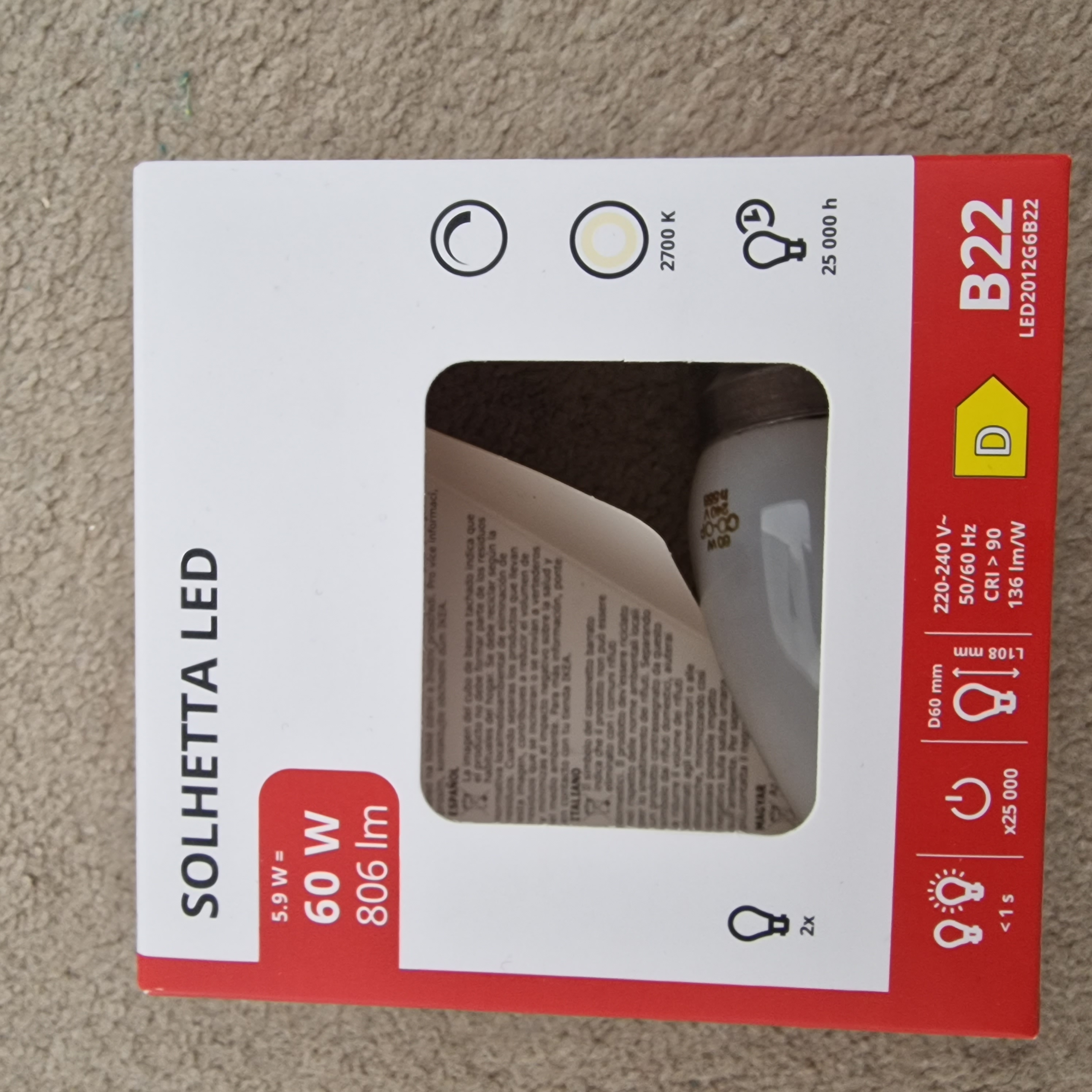

I have connected up a dimmable led light bulb with a solid state relay from analogue 1 on the A4Sbut i seem to be getting the following problems.
1: when the relays are off from the color LED-1 in Home assistant the bulb is still on but very dim. when i switch it on it goes full brightness but when i switch off the bulb does not go out it goes back to very dim.
2: i set up a automation to use a momentry input switch to increase brightness and another input to dicrease brightness, again the bulb is still on when off but now i have to keep pressing the button several times to increase brightness instead of just holding the button. I also notice that the bulb starts to flicker at certain increases. can you explain whats going wrong please.
3: i have attached the photos to make sure it is all wired correctly.
