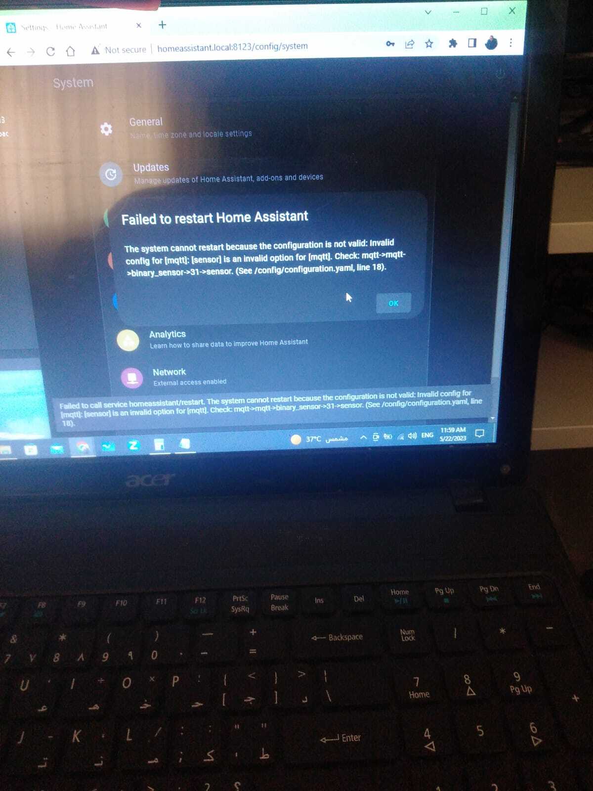

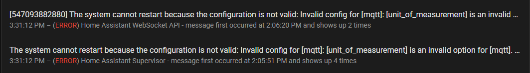

I have some problem when I add analog in my yamal file
--give me wrong when I make restart
--and all mqtt stop
---when i remove all thing good
this my yamal file in attach

upload your error information screen.
(05-22-2023, 10:43 AM)admin Wrote: upload your error information screen.
take photo of your line18. Do you have showed, your line18 have problem.
(05-22-2023, 11:03 AM)admin Wrote: take photo of your line18. Do you have showed, your line18 have problem.

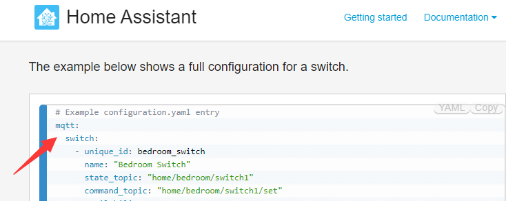

please check the mqtt syntax. there should be two space.

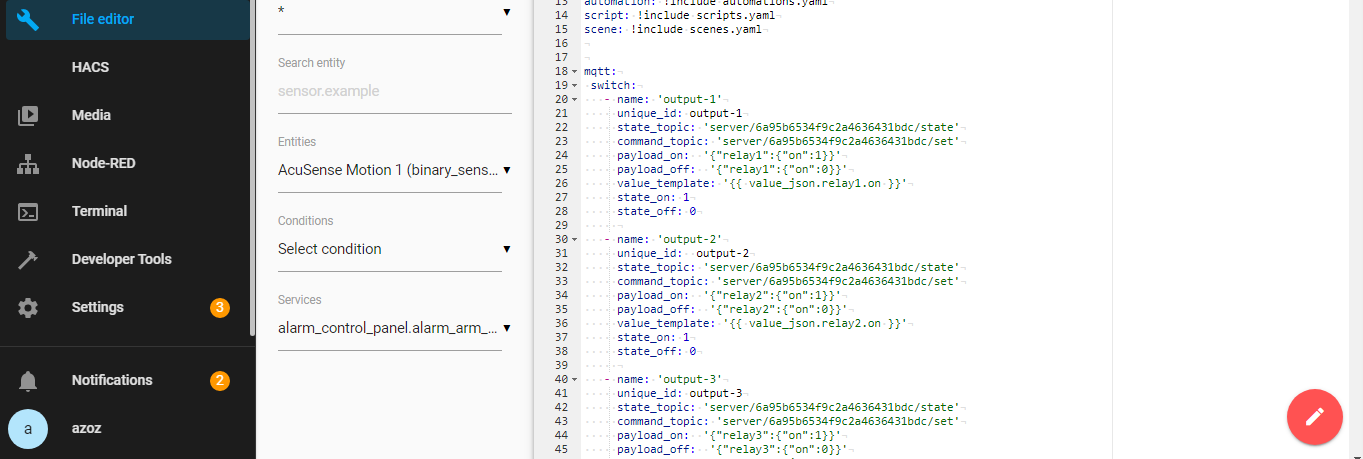

(05-22-2023, 11:32 AM)admin Wrote: please check the mqtt syntax. there should be two space.
ther is no problem in any switch
when i add analog all problem coming Big Grin
just please confige analog sensor with degital and give me same same example
you error message showed line18. just update it. also take photo of your analog sensor code.
