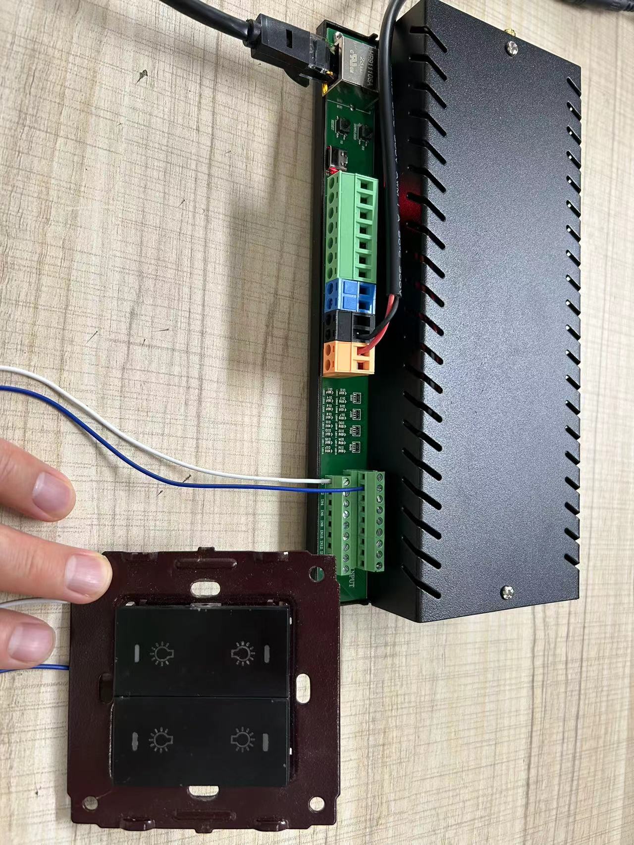

this is 3 mode for KC868-A16S controller set by ESPHome:
1-click: toggle relay1
2-click: toggle relay2
3-click: toggle relay3
actually you can add 4-click, 5-click, 6-click, ........
tested with KC868-A16S
mainin use these code:
binary_sensor:
  - platform: gpio
    on_multi_click:
    - timing:
        - ON for at most 0.5s
        - OFF for at most 0.5s
        - OFF for at least 0.5s
      then:
        - switch.toggle: a16s_output3
    - timing:
      then:
        - switch.toggle: a16s_output2
    - timing:
      then:
        - switch.toggle: a16s_output1
    pin:
      pcf8574: pcf8574_hub_in_1
      number: 0
      mode: INPUT
      inverted: true
.txt   Made_for_ESPHome_KC868-A16S - multi-click.txt (Size: 6.28 KB / Downloads: 778)
