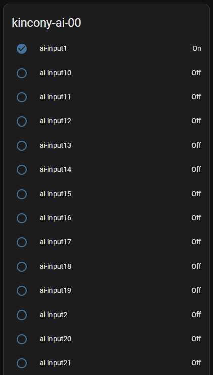

Additionally, I just tried to replace the ethernet connection setup, with my default wifi config.
This works and in that way I'm able to add my AI board via esphome to home assistant (see attachment).
So this would mean there is something wrong with the ethernet config?

KC868-AI for ESPHome 2025.11.0 version. yaml file:
.txt   KC868-AI_ESPhome.txt (Size: 7.83 KB / Downloads: 110)
  friendly_name: kc868-ai
esp32:
  board: esp32dev
  framework:
    type: esp-idf
