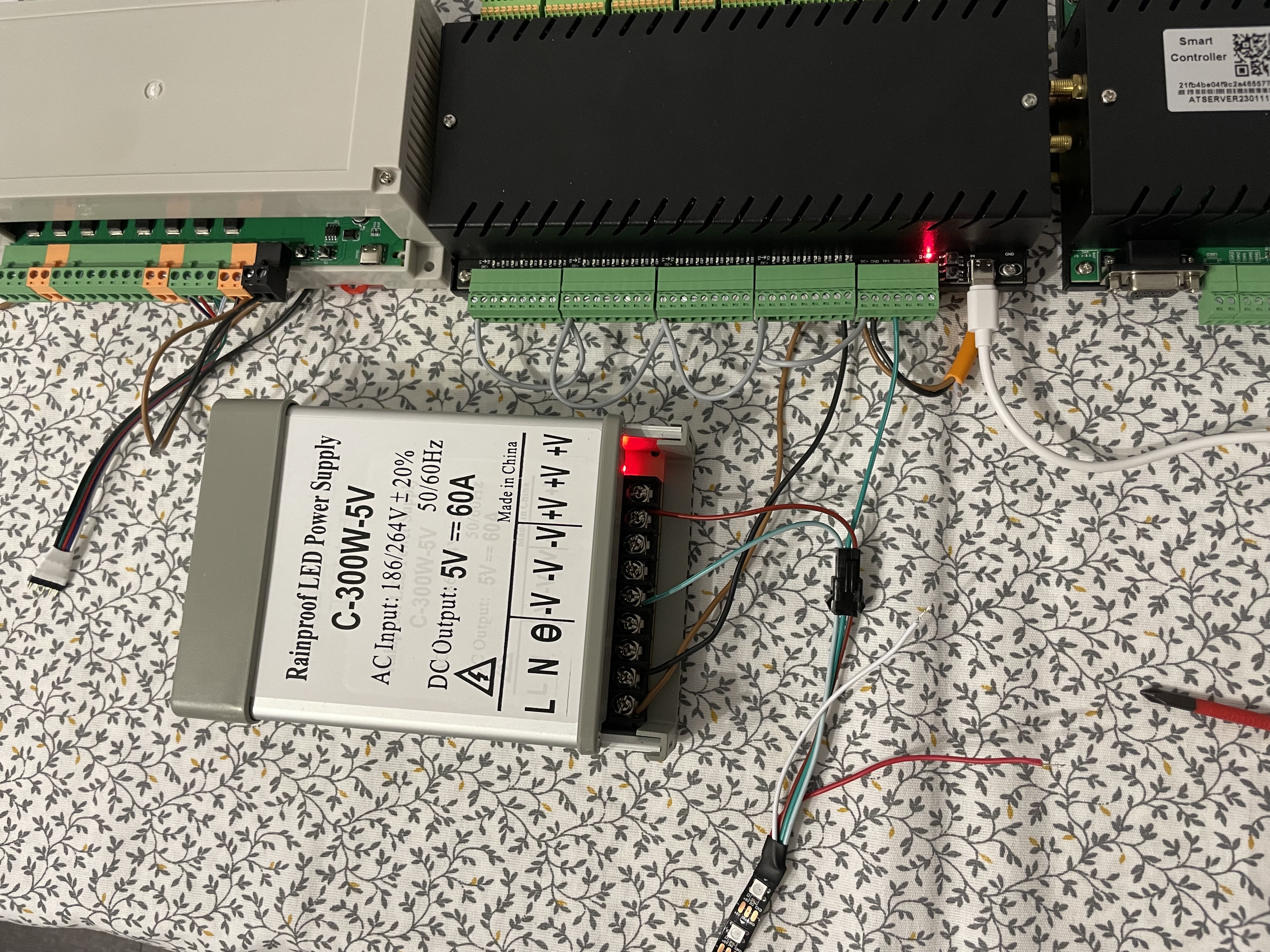

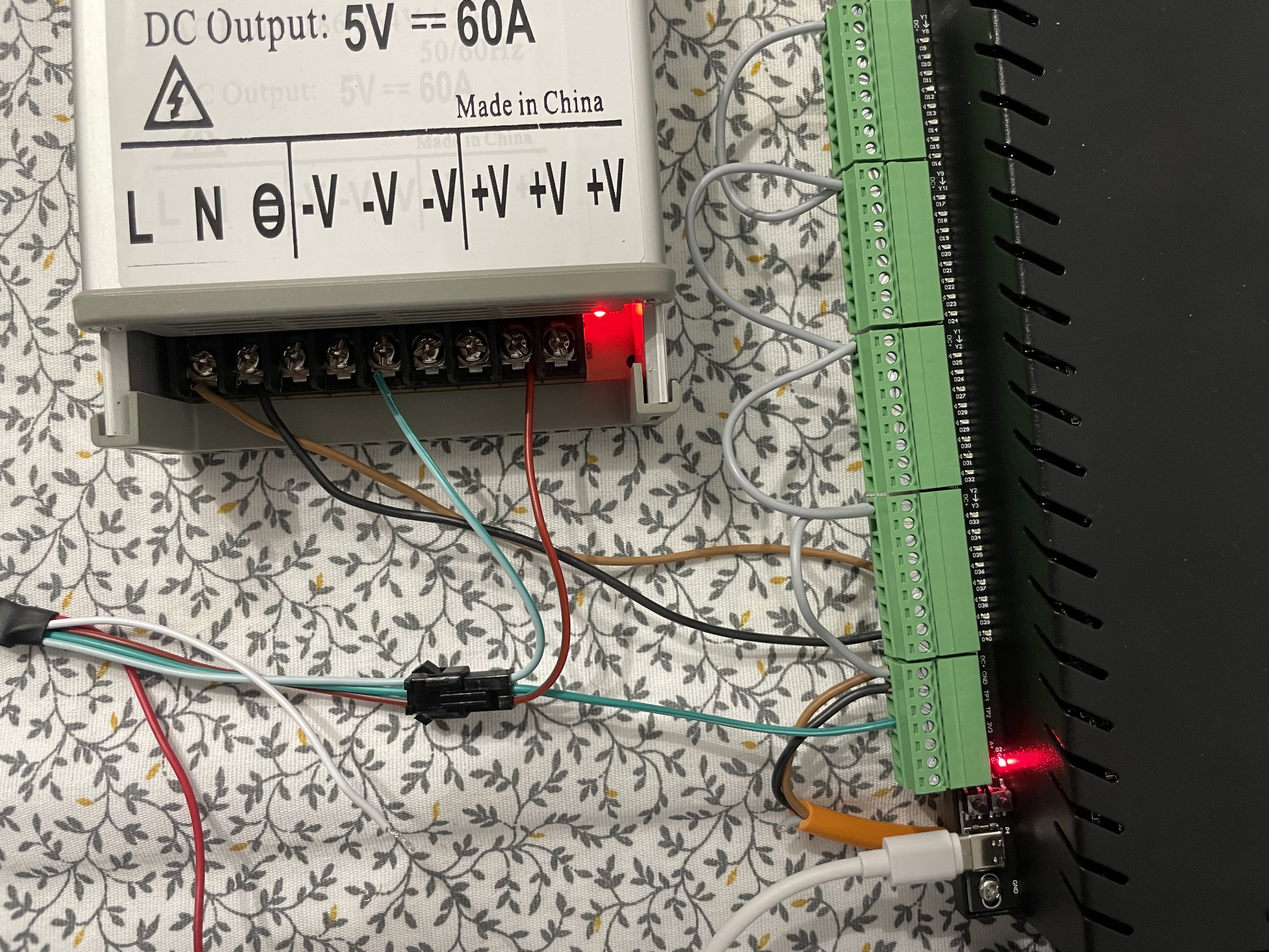

take a photo , how you wire?
Posts: 42
Threads: 0
Joined: Jun 2023
Posts: 9,782
Threads: 1,331
249
do you use dc12v power supply for KC868-AIO and dc5v power supply for LED strip?
two power supply whether have connect the "GND" together?
Posts: 42
Threads: 0
Joined: Jun 2023
Yes , i use 5 V supply for led strip and 12 V for AIO .
The power supply grounds are not connected toghether.
Posts: 9,782
Threads: 1,331
249
you should connect together for two "GROUND".
