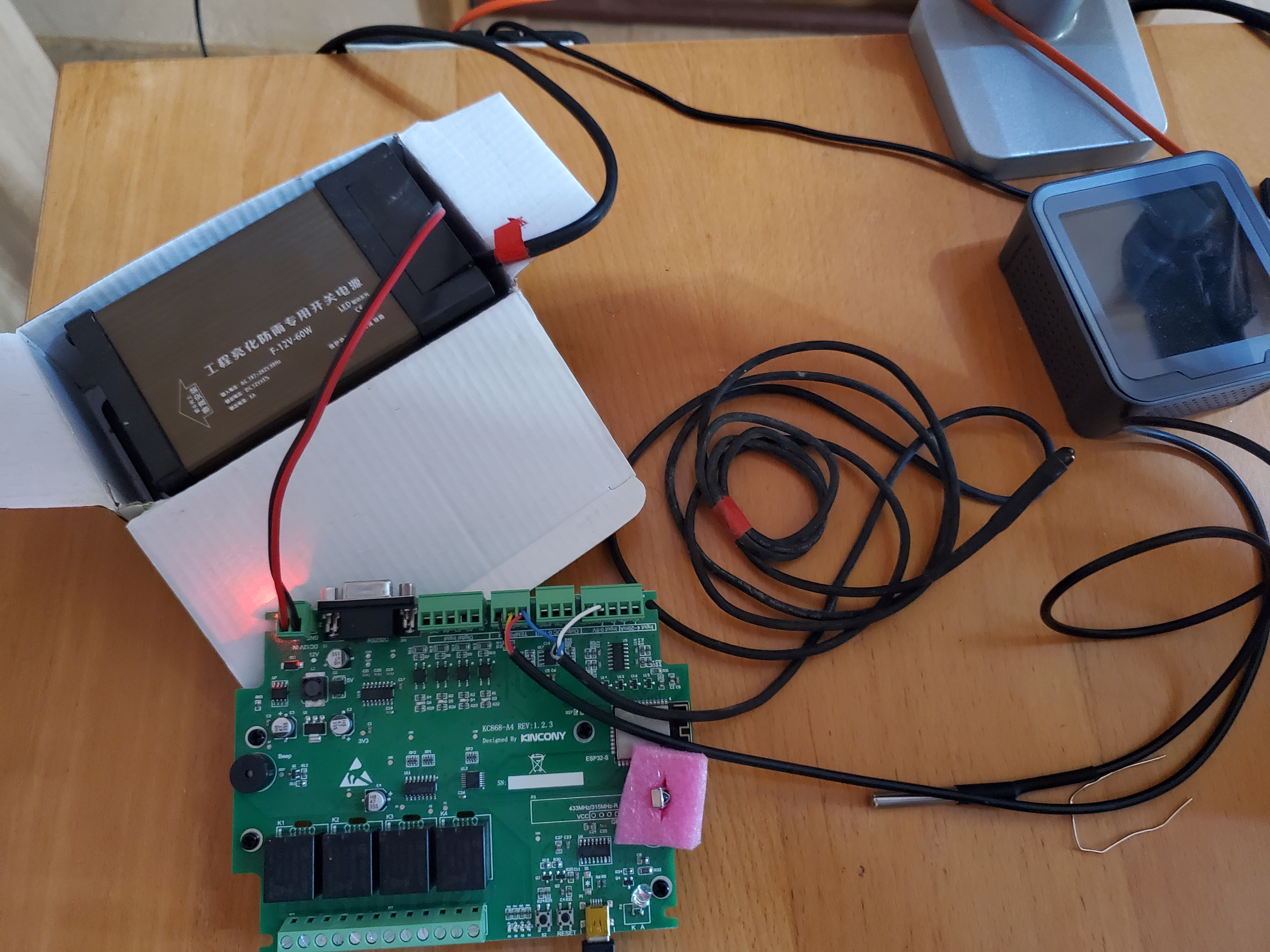

what power supply you have used for A4 board?
Can you take a photo how you wire with your A4 board.
#16
(06-23-2023, 10:38 PM)admin Wrote: what power supply you have used for A4 board?
The PS is 12v 60W.
Here is my wiring.
The same PS and wiring I am using With KCS1.0, and it works, except for the analogic updatesby mqtt
#17
why your sensor not connect to GND? i think your wire is wrong.
analog output sensor, should connect to AI and GND.
#18
(06-24-2023, 09:49 PM)admin Wrote: why your sensor not connect to GND? i think your wire is wrong.
My temp sensor  (I attached the litterature) has a GND well connected toAGND,it is hidden in my picture. It works well like that in KCS v1.
