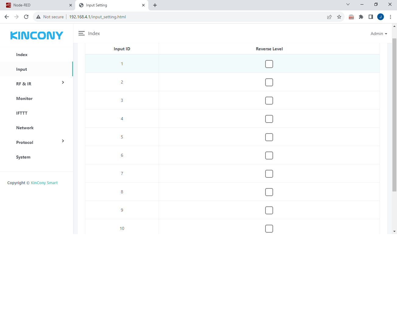

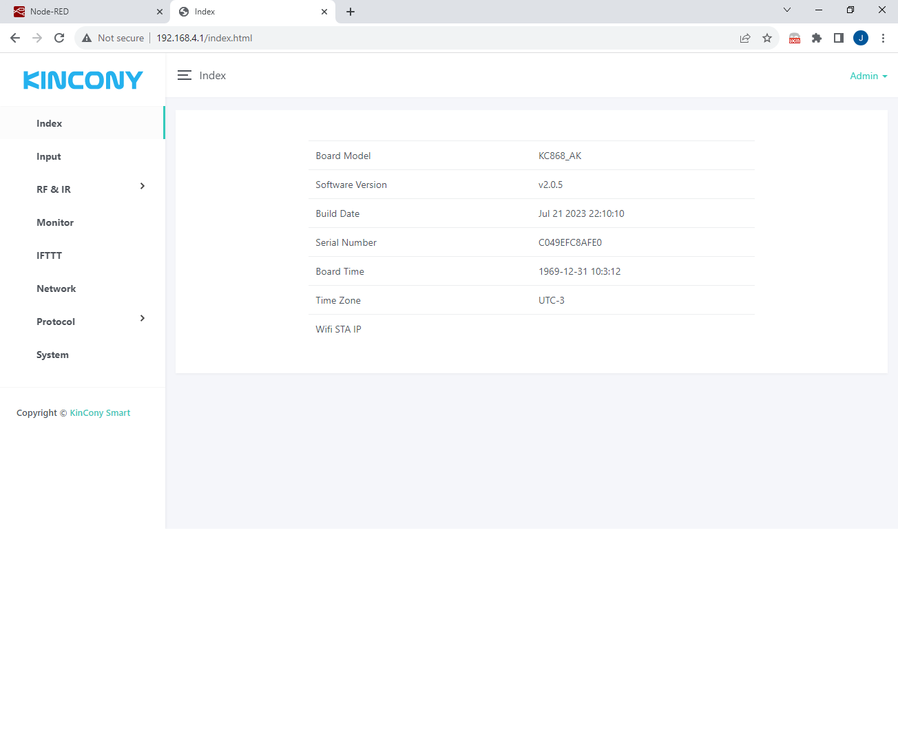

Hi! I have a KC868-AK and I updated to Firmware 2.05 (KCS), however I lost the options to customize input action with H32B-PRO. 1 click, 2 clicks and hold.
set IFTTT command by "DI" . now have more functions.
[Image: if-DI.png]
here is details of guide:
https://www.kincony.com/esp32-kcsv2-firmware.html
Thanks! I saw here how it works, as the H32B PRO works in RS 485 there is no need to send messages in the custom protocol. However, it is not possible to turn on or off more than one relay output of the controller. Correct?
H32B Pro support one command for turn ON/OFF/TOGGLE any relays .
So can I program IFTTT to do what the old firmware did: turn on any relay with one click, turn off another relay with two clicks?  And turn off all relays with the same button when hold. As per the figure:
you can create 3 IFTTT command by one digital input port. such as: DI-1 1-click actions, DI-1 2-click actions, DI-1 hold on actions.
And how do I make DI1 turn on outputs 1, 2 and 3 with 1 click and then turn off these outputs with 2 clicks?
