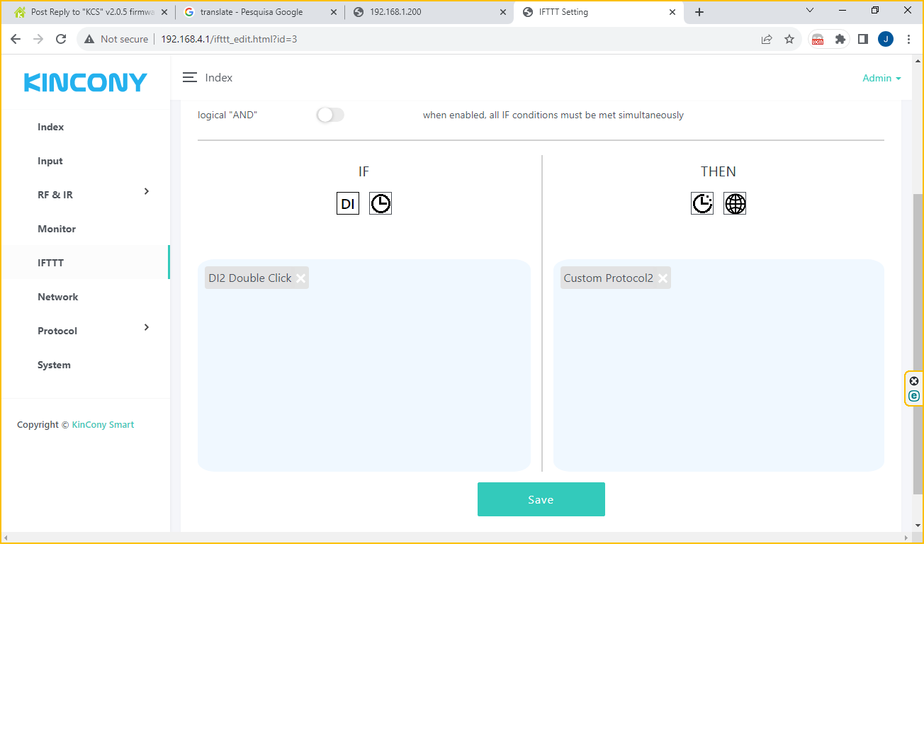

It sure would be great to help. Thank you very much. But, in advance, I didn't find DO in IFTTT in the KC868-AK settings, here it only appears Delay and CUSTOM PROTOCOL, according to the printscreen.
#13

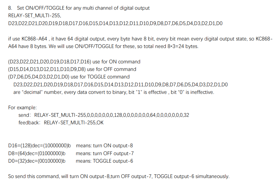

yes, because KC868-AI not have digital output ports. so need to use by custom protocol.
you can list your actions you wanted, such as :
1 click:  relayX ON, relayX OFF
2 click: xxxxxxxxxxx
hold on:  xxxxxxxxxxxx
then i will tell you how to write the custom protocol.
this will need new firmware to support that, we will released it soon, when finished, i will take video for you how to use.
