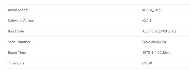

Anyway was trying to get the NTP to work, see my attachment.
Tried a few like ntp.org time.windows, but all doesn't work.
Abe to advice what NTP server works.

"Time zone" set in system webpage. you can set your own "time zone".
