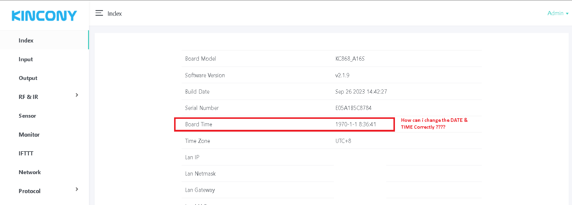

Good day everyone, How can i change the BOARD TIME?  im using the KC868-A16S v2.1.9... The board time is 1970-1-1 8:36:41, i want to update the date and time.
Thank you..
connect board with internet, board time will auto update from internet. just you need to set the time zone.
(11-11-2023, 08:32 AM)admin Wrote: connect board with internet, board time will auto update from internet. just you need to set the time zone.
the board is already connected to my router LAN and WIFI with internet. but still date and time not updated.
is there other settings i need to change ? network ?
check your time zone whether set correctly.
It did not work for me, but i want to share to everyone or to someone who has same board time problem, use time.nist.gov. see pictures.
Thank you admin.
ok, thanks.
