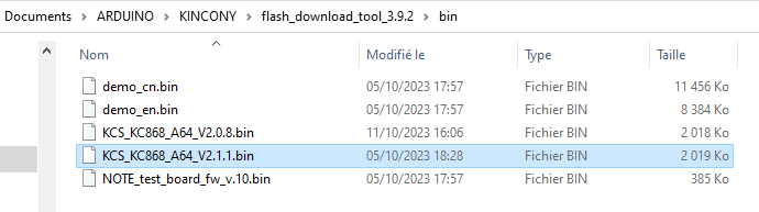

how you download firmware of KCS? can you take a screen photo of setting, upload at here.
(11-01-2023, 10:34 PM)admin Wrote: how you download firmware of KCS? can you take a screen photo of setting, upload at here.
Attached the screen shots + the screen shot with TUYA that correctly work .
I tried also to download with the adress 0x010000 (seen on one of yours documents), but also doesn't work
download KCS firmware, address is 0x0
if can't download. lower your COM port Baud rate.
Sorry I don't understand, can you give me the link for the "KCS firmware" you mean ?
