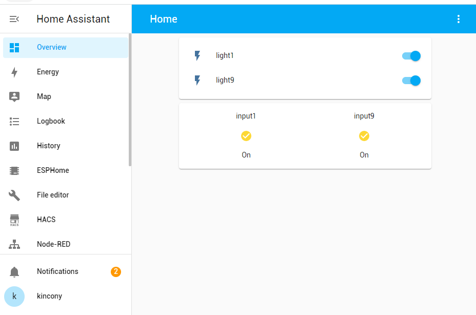

KC868-A16 ethernet work with home assistant by ESPHome configure
  platform: ESP32
  board: esp32dev
i2c:
  sda: 4
  scl: 5
  scan: true
# Example configuration entry
ethernet:
  type: LAN8720
  mdc_pin: GPIO23
  mdio_pin: GPIO18
  clk_mode: GPIO17_OUT
  phy_addr: 0
  # Optional manual IP
  manual_ip:
    static_ip: 192.168.1.199
    gateway: 192.168.1.1
    subnet: 255.255.255.0
pcf8574:
    address: 0x24
    address: 0x25
    address: 0x21
    address: 0x22
# Individual outputs
  - platform: gpio
    pin:
      pcf8574: pcf8574_hub_out_1
      # Use pin number 0
      number: 0
      # One of INPUT or OUTPUT
      mode: OUTPUT
      inverted: false
  - platform: gpio
    pin:
      pcf8574: pcf8574_hub_out_2
      # Use pin number 0
      number: 0
      mode: OUTPUT
      inverted: false
binary_sensor:
  - platform: gpio
    pin:
      pcf8574: pcf8574_hub_in_1
      # Use pin number 0
      number: 0
      mode: INPUT
      inverted: false
  - platform: gpio
    pin:
      pcf8574: pcf8574_hub_in_2
      # Use pin number 0
      number: 0
      mode: INPUT
      inverted: false
# Enable Home Assistant API

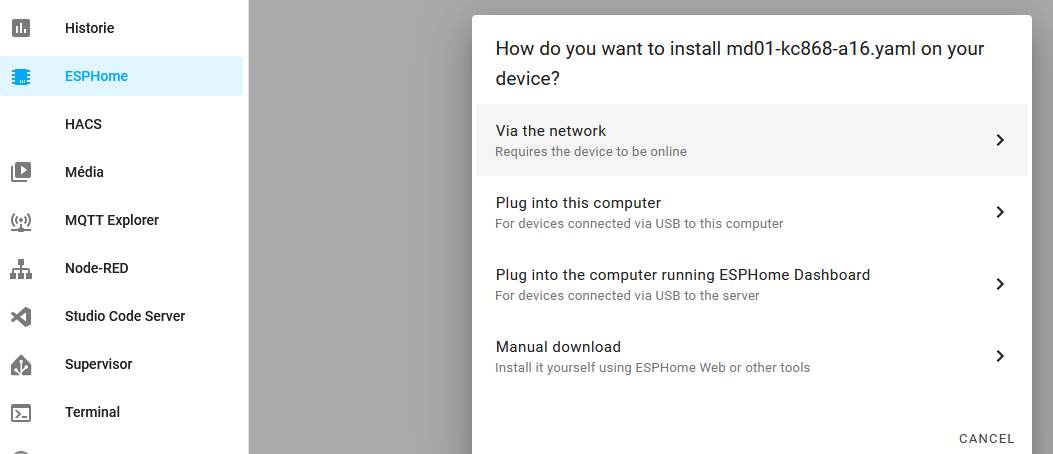

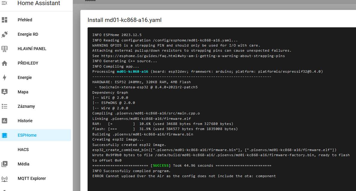

But if I make a change in the YAML file in ESPHome and choose the first option "Via the Network" in the "Install" dialog, the installation ends with an error - see the picture. (at that time, A16 is on the LAN network - it is not connected via WiFi cable in the place and Device is "ONLINE" in ESPHome).
What should I change?

because now your A16 is connected by ethernet cable, not use by wifi. also you have not config OTA in yaml.
if you want to use easier, just download by USB-C cable is ok.
(06-12-2024, 02:45 AM)admin Wrote: because now your A16 is connected by ethernet cable, not use by wifi. also you have not config OTA in yaml.
how to configure OTA, is there any tutorial for this?
see here: https://esphome.io/components/ota/esphome.html
