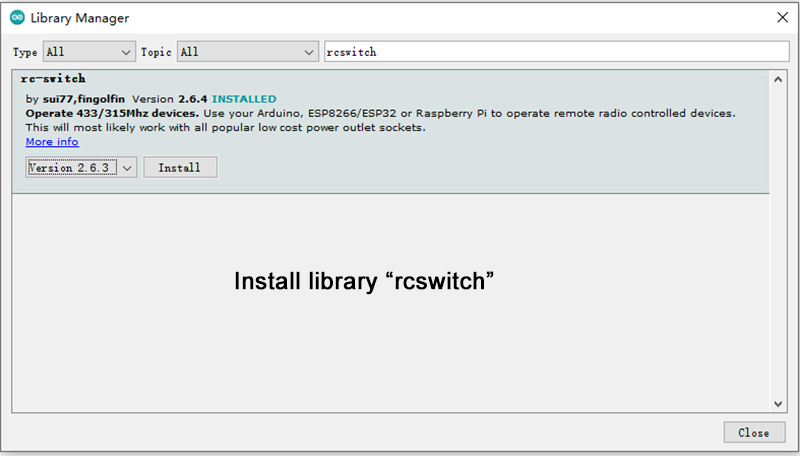

[Arduino IDE demo source code for KC868-AG]--#01-433Mhz send code
Lightbulb
Code 1: //The demo code is RF-send  You can copy the code to your Arduino IDE
