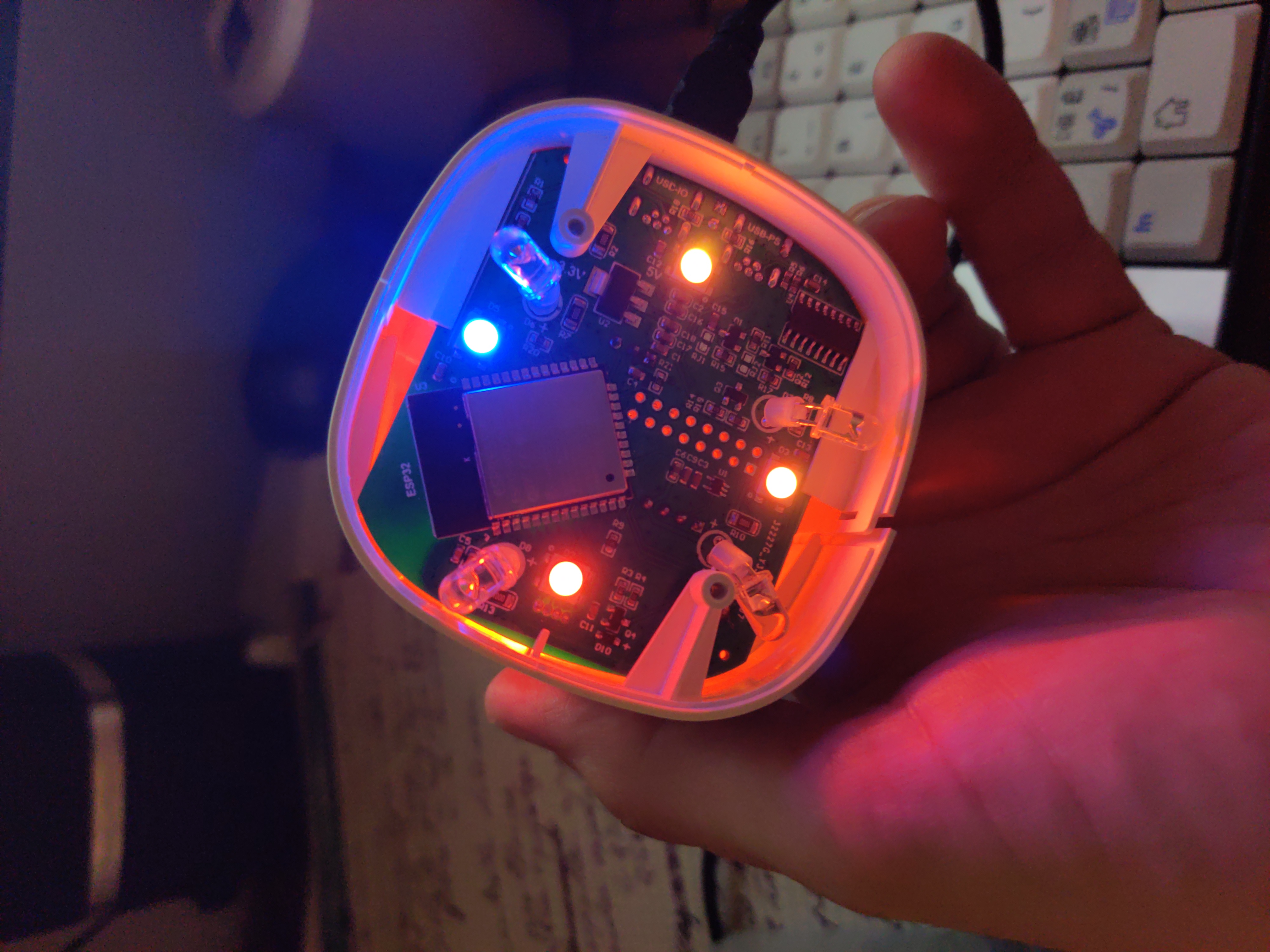

Thanks for code it works this way but it's using old RGB implementation mode of ESPHome Wink
In fact the device has a hardware issue as one of the ring LED is wired with bar so only 3 LEDs of ring work together, the other one works with bar which kills the visual effect of the ring !! Are you aware of that problem on the device ??

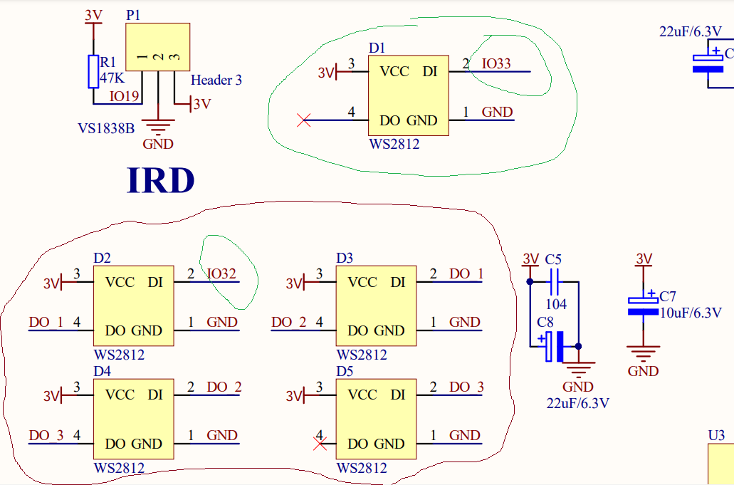

no, 4 LEDs work together with ring LED. another one LED is indepentant. here is diagram, you can see details.
(03-11-2022, 11:03 PM)admin Wrote: no, 4 LEDs work together with ring LED. another one LED is indepentant. here is diagram, you can see details.
Thanks for the schematics but it doesn't correspond with reality ! Have a look at my picture you can clearly one of the LED is not following the other ones on ring but the ones of bar Sad

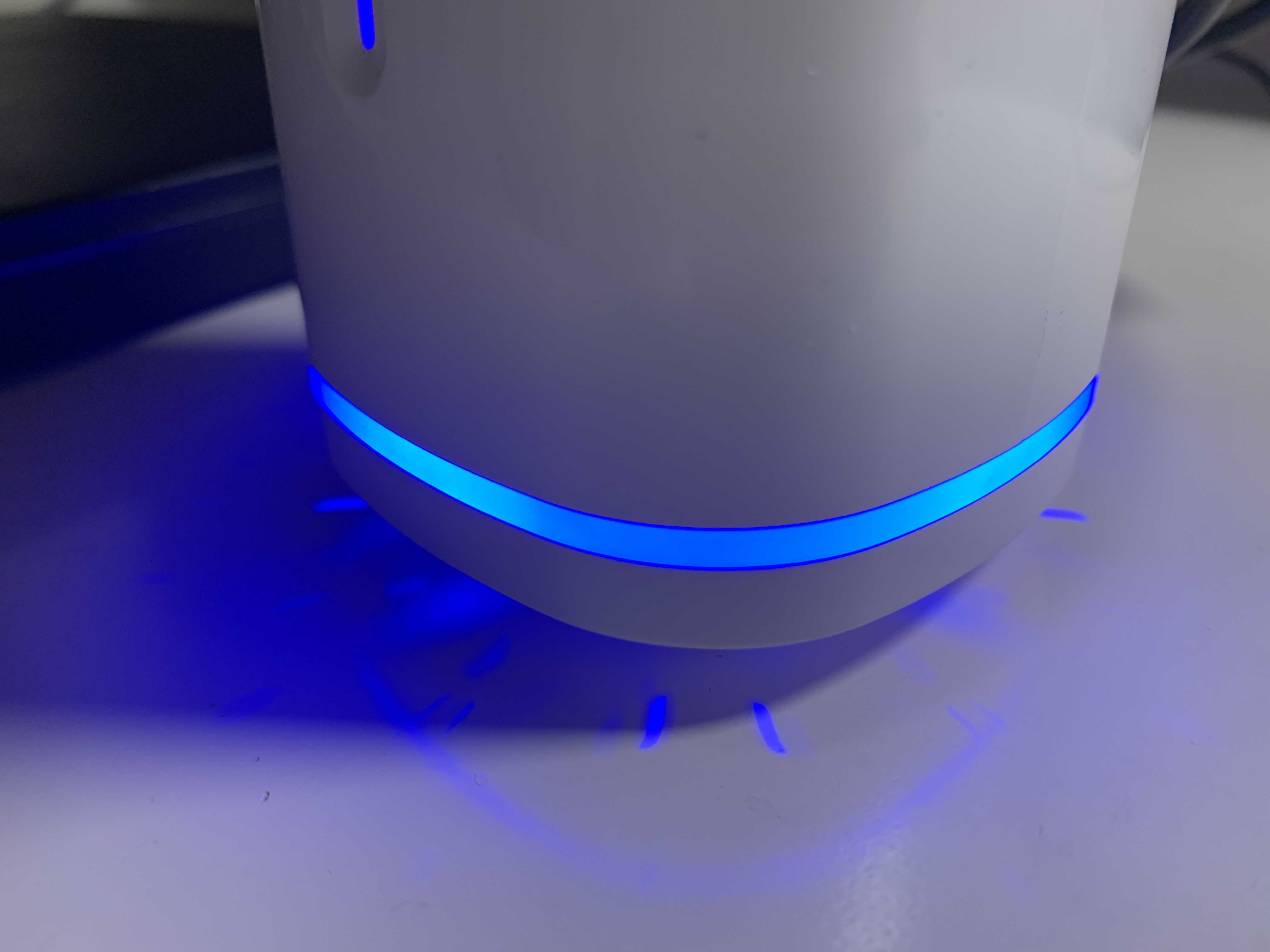

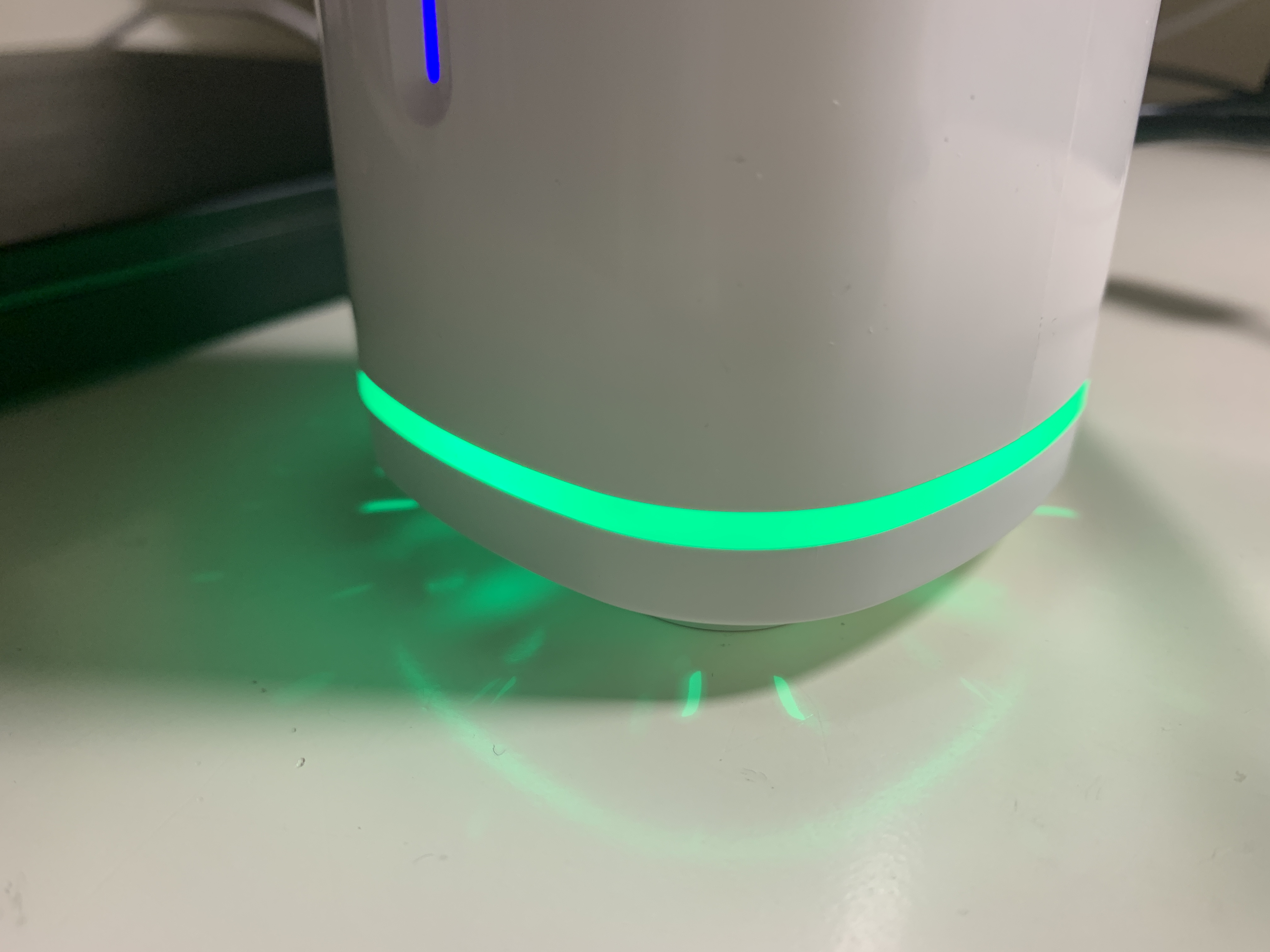

i think you need to check software, hardware is no problem, here is some our demo images.
