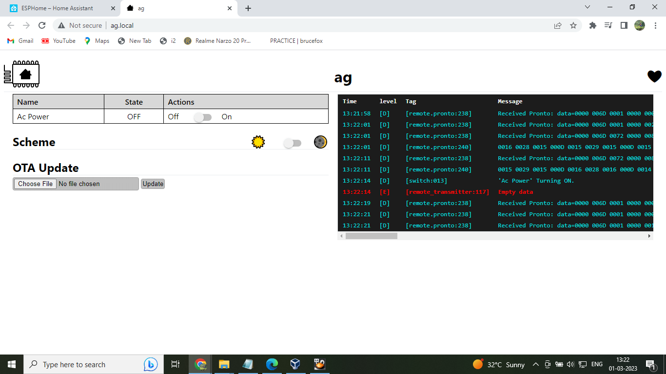

My Ac remote sending pronto codes and im execute the code in my yaml file but output shows these commands "Ac turning on" and  "empty data".But still no response from ac side. what are the lines im copy from the pronto code for "on operation"? and attached the screen shot of output window and yaml code
.txt   Whirlpool Ac.txt (Size: 1.31 KB / Downloads: 473)

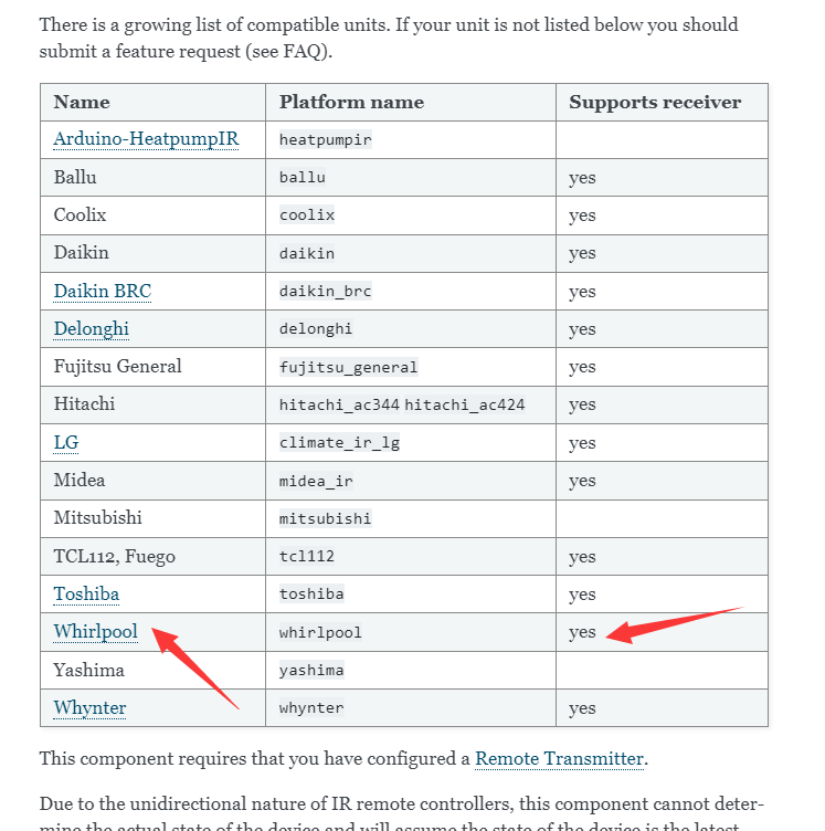

if you use KC868-AG by ESPHome, ESPHome IR Remote Climate already supported your brand "Whirlpool". why not directly to use it? i think you not need to learn IR.
you can see here, already included your brand "Whirlpool":
https://esphome.io/components/climate/climate_ir.html
here is photo.
