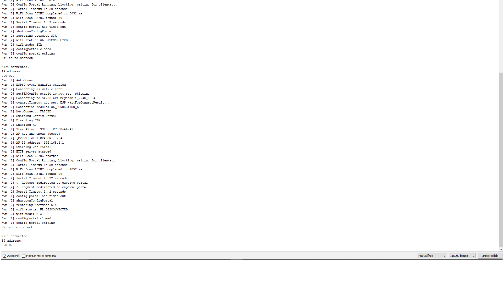

buen dia intento compilar el código y hace todo lo de la conexión pero al final me dice ip 0.0.0.0 y no me deja conectarme a ap 192.168.4.1
Do you have replaced wifi ssid and password in code?
(09-09-2024, 11:05 PM)administración Wrote: ¿Has reemplazado el SSID y la contraseña del wifi en el código?
Si ya lo hice , de hecho use otro codigo para conectarme como cliente web y si funcionó , en el código que ustedes enviaron dice no conectado. Me pueden ayudar por favor , gracias de ante mano

Compiled successfully.
But on the serial monitor i can see this:
���Ƶ���9����� !�*wm:config portal has timed out
*wm:config portal exiting
Failed to connect
WiFi connected.
IP address:
0.0.0.0
is this normal?
do you have replace your router's ssid and password.l
Yes, I added the correct network, but I see this:
clk_drv:0x00,q_drv:0x00,d_drv:0x00,cs0_drv:0x00,hd_drv:0x00,wp_drv:0x00
modeBig GrinIO, clock div:1
load:0x3fff0030,len:4832
load:0x40078000,len:16460
load:0x40080400,len:4
load:0x40080404,len:3504
entry 0x400805cc
*wm:AutoConnect
*wm:No wifi saved, skipping
*wm:AutoConnect: FAILED for  1 ms
*wm:StartAP with SSID:  KC868-A6-AP
*wm:AP IP address: 192.168.4.1
*wm:Starting Web Portal
*wm:28 networks found
Failed to connect
WiFi connected.
IP address:
0.0.0.0

Shall I join to the kc869 AP?
Ot it is enough that both device is on the same network?
it should work in STA mode. you can also try to download our BIN file directly.
