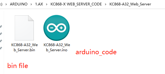

[Arduino IDE demo source code for KC868-A32]--#07-KC868-A32_Web_server_code
.zip   KC868-A32_Web_Server.zip (Size: 483.68 KB / Downloads: 773)
* Create Your own WebServer for KC868-A32 Smart Controller*
