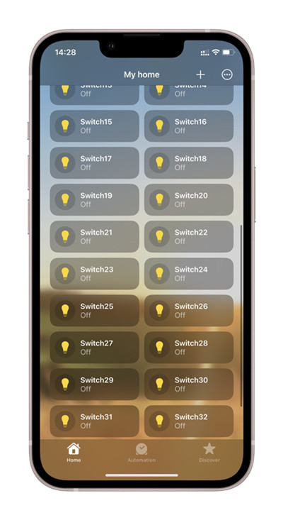

5. begin to pair with Apple HomeKit App
after paired with HomeKit app, LED "D46" green LED will be always ON.

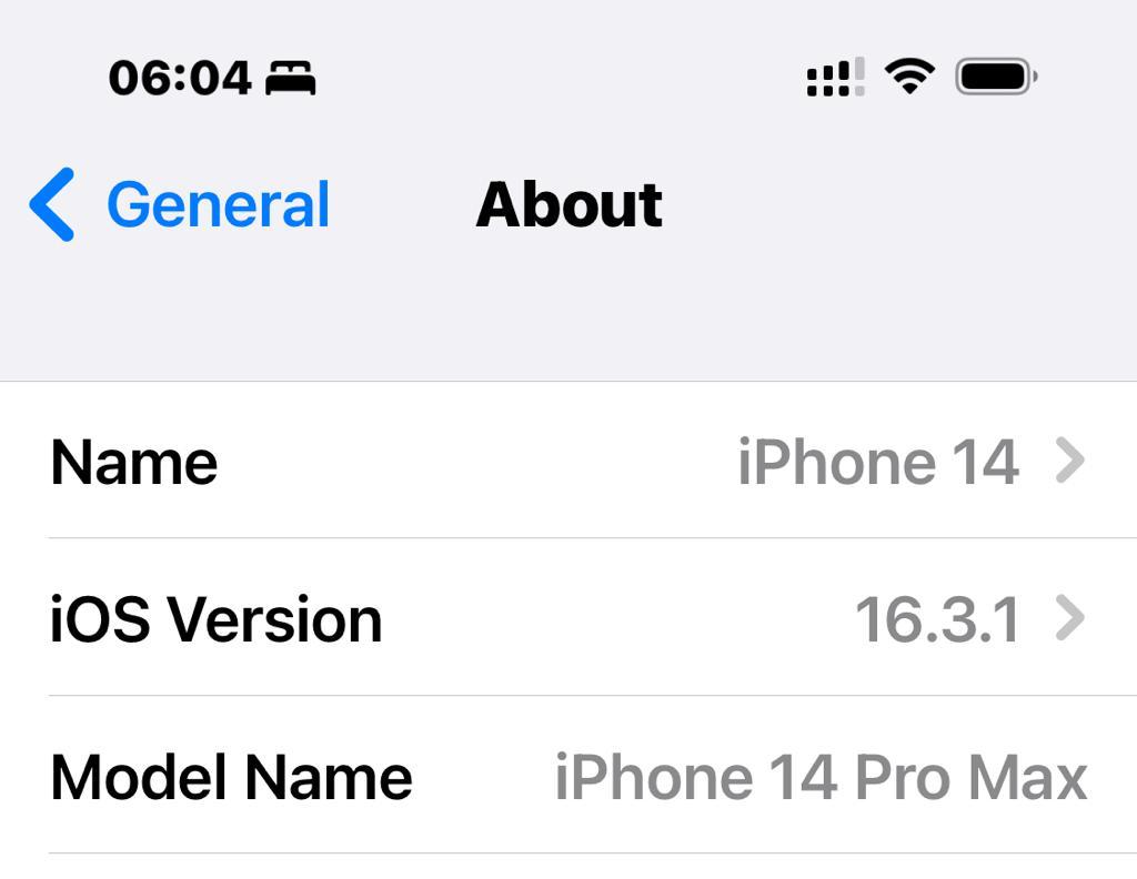

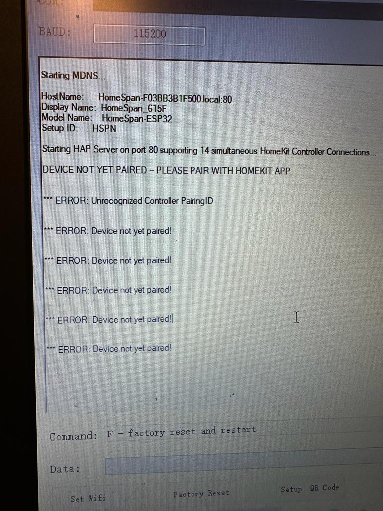

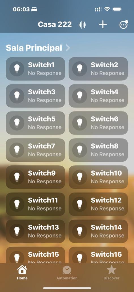

my name is Cassiano, can you please help me with my new KC868-H32B Pro ?  when connecting to app home in my iphone,    i m receiving this message - Unrecognized Controller PairingID and then shows ERROR: Device not yet paired!, ( see attached pics )
DEVICE NOT YET PAIRED -- PLEASE PAIR WITH HOMEKIT APP
* ERROR: Unrecognized Controller PairingID
* ERROR: Device not yet paired!
