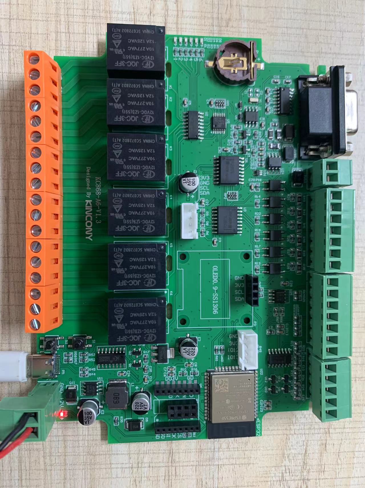

Looking closely at the circuit board, just near the DS1307 chip, the capacitors C1 and C2 are missing.
Would this be the issue?
we have tested, not C1,C2 problem. C1, C2 not need to use. you can download our BIN file directly to test.

Can you compare my photos carefully to see if there are any missing components on the PCB board.
Hi again
I've looked over the board and I can't see anything missing or any cracks in any tracks etc.
