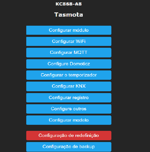

ola personal, someone has already cofollowed install the tasmota, I can install more does not open the field to configure the pulse input, someone has already managed

even following these steps does not appear the option of PCF8574 to activate

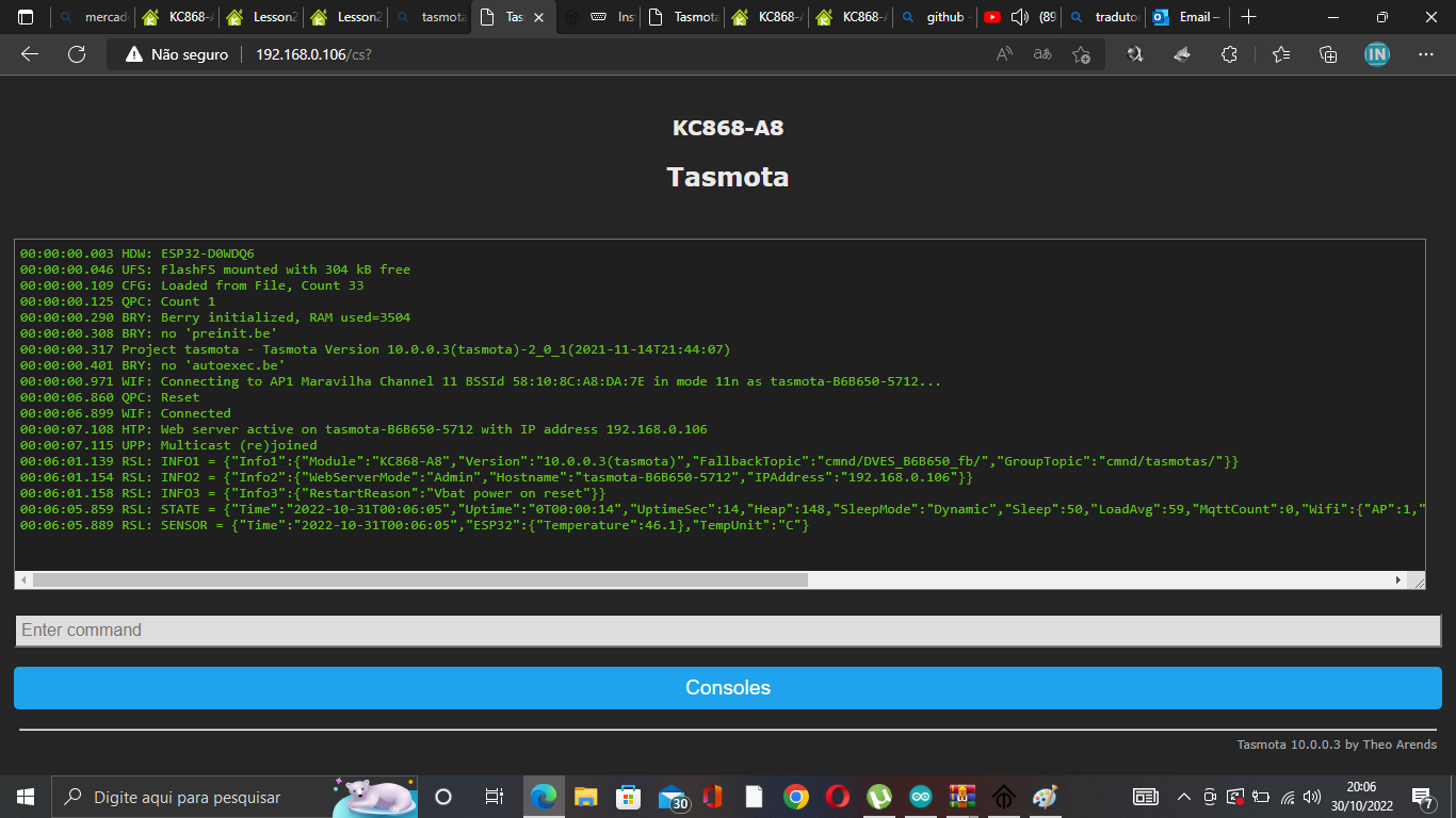

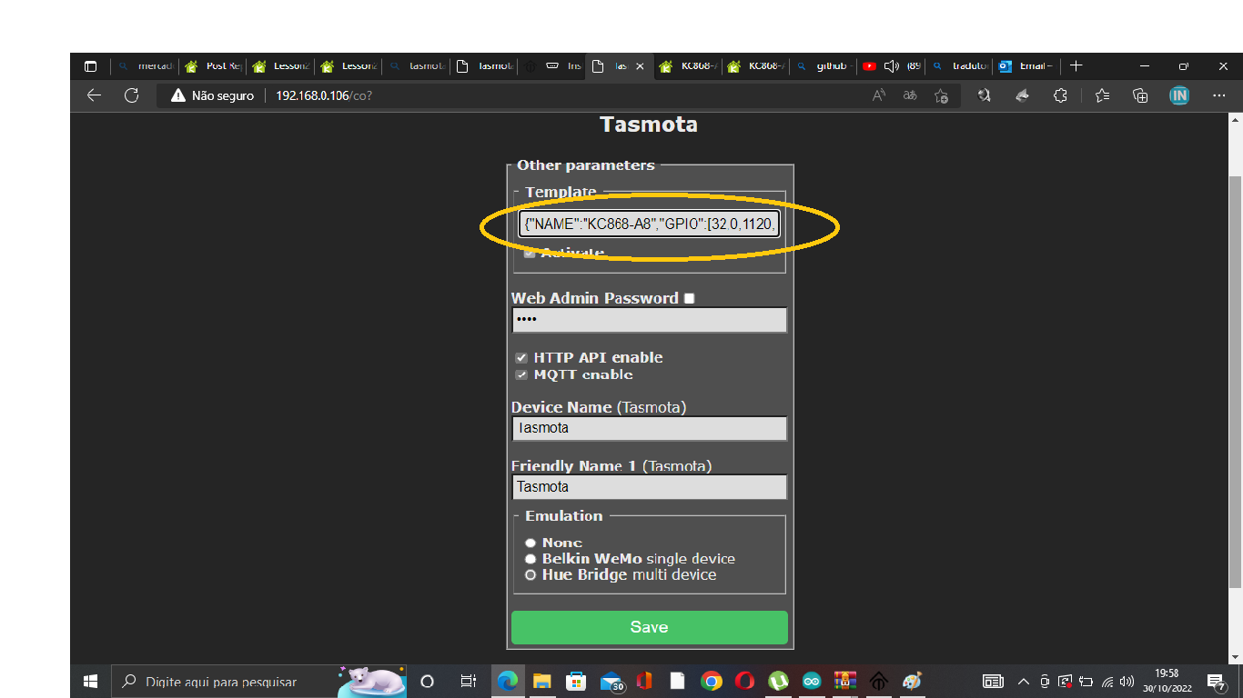

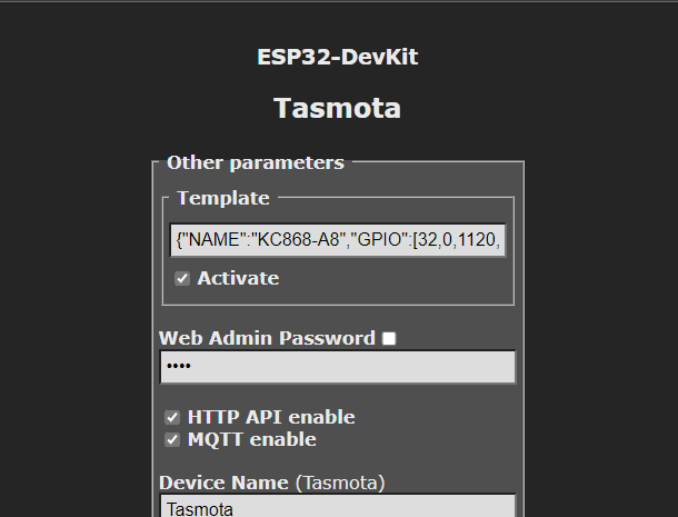

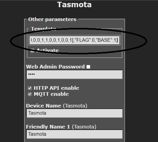

exactly, I have another board and it worked, in this not, I realized that whenever saved, changes the configuration, different from the tutorial , does not save the last settings
{"NAME":"KC868-A8","GPIO":[32,0,1120,0,640,608,0,0,0,1,1,1152,0,0,5600,0,0,0,0,5568,0,0,0,0,0,0,0,0,1,1,0,0,1,0,0,1],"FLAG":0,"BASE":1}
KC868-A6 need use tasmota by wifi, not by ethernet, maybe you have copy A8's setting? that have ethernet setting.

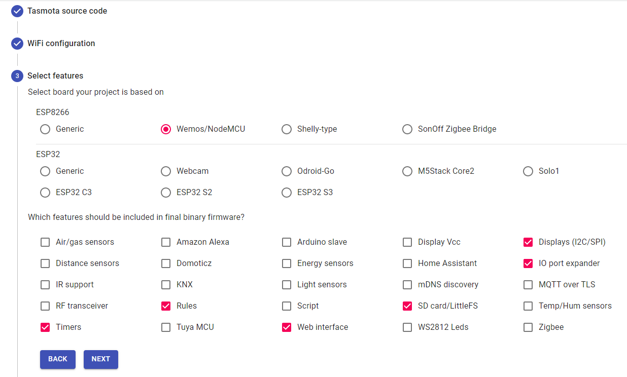

I understand, how can I get the tasmota wifi firmware for the A6?would have some step by step
I think you can use this tasmota cloud compiler tool to generate firmware BIN file, it's very easy.
https://github.com/benzino77/tasmocompiler
you can try to use this firmware. unzip and download BIN file to ESP32.
