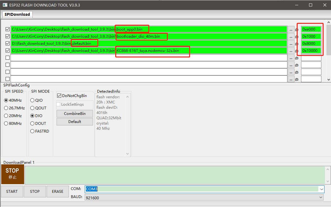

Here is Factory Original Firmware for KC868-E16T. You can use Tuya mobile phone application directly. it supprt remote control by internet and manual control buttons on board.
.zip   KC868-E16T_tuya.nodemcu-32s.zip (Size: 116.22 KB / Downloads: 1,080)
some people after downloaded ESPHome firmware for home assistant, if you want to use tuya app again, you can download the  Factory Original Firmware for recovery.
about ESP flash tool download link and details see here : https://www.kincony.com/esp-module-flash...tools.html
need add 4 files,set the address like the   picture
