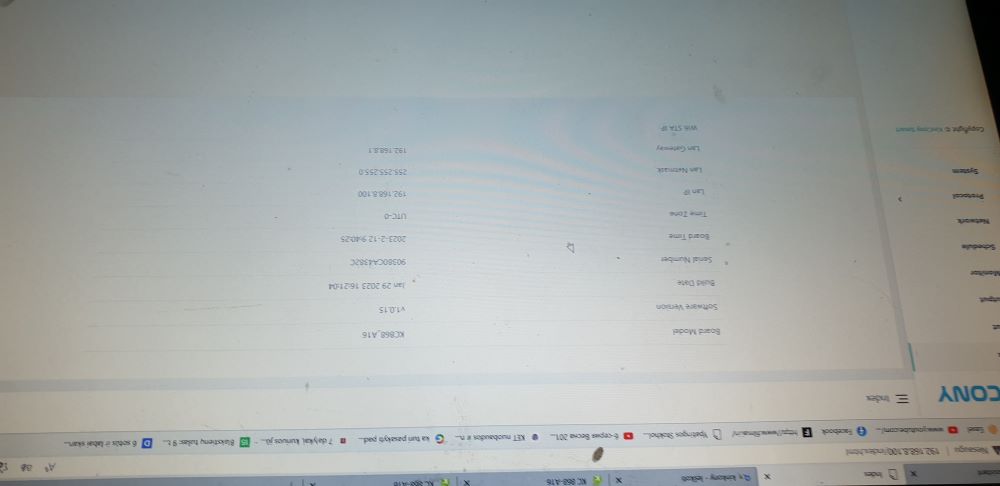

your state_topic and command_topic is wrong.
you only need add 16 DO and 16 DI command. The server topic because i have also added KC868-Server, you not need to use. so you need to 16 DO and 16 DI as these format:
  - name: 'a16-kcs-output-1'
    unique_id: a16-kcs-output-1
    state_topic: 'KC868_A16/B48A0A404560/STATE'         replace B48A0A404560 with your boad's ID, you can check in your board webpage.
    command_topic: 'KC868_A16/B48A0A404560/SET'       replace B48A0A404560 with your boad's ID, you can check in your board webpage.

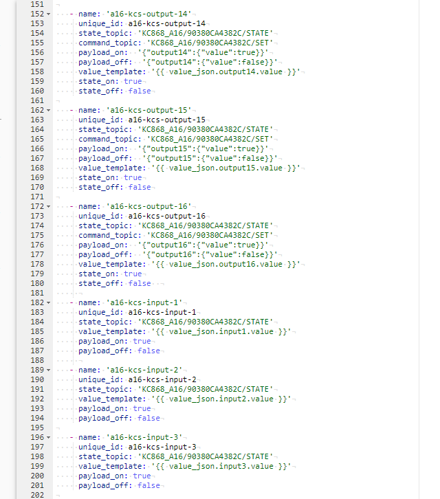

i have told you to use:
state_topic: 'KC868_A16/90380CA4382C/STATE'
command_topic: 'KC868_A16/90380CA4382C/SET'
but you are using: (it's mistake) Do you see it??
state_topic: 'KC868_a16/KC868_A16/90380CA4382C/STATE'
command_topic: 'KC868_a16/KC868_A16/90380CA4382C/SET'

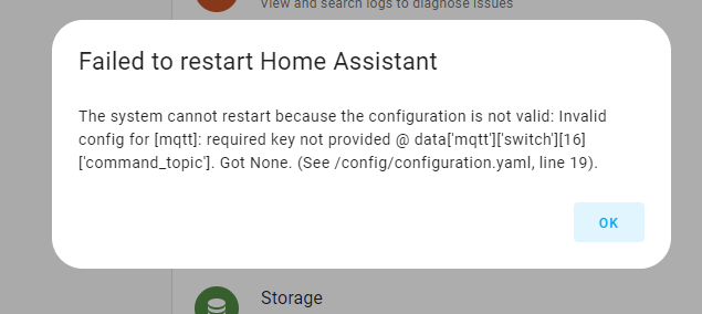

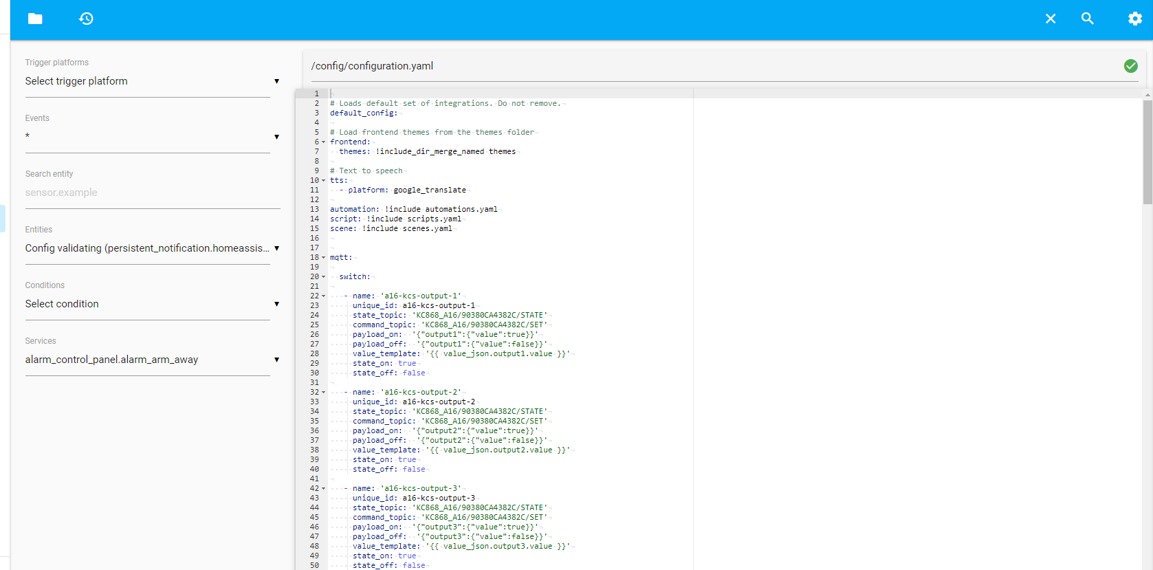

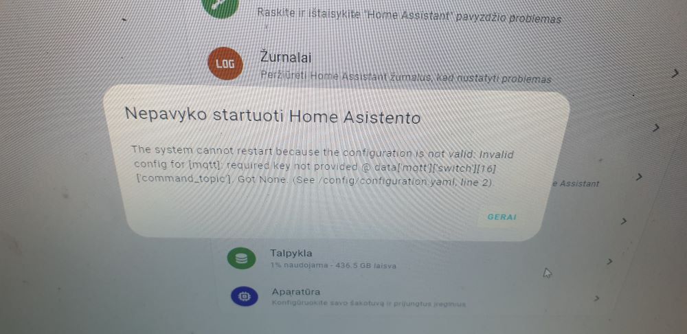

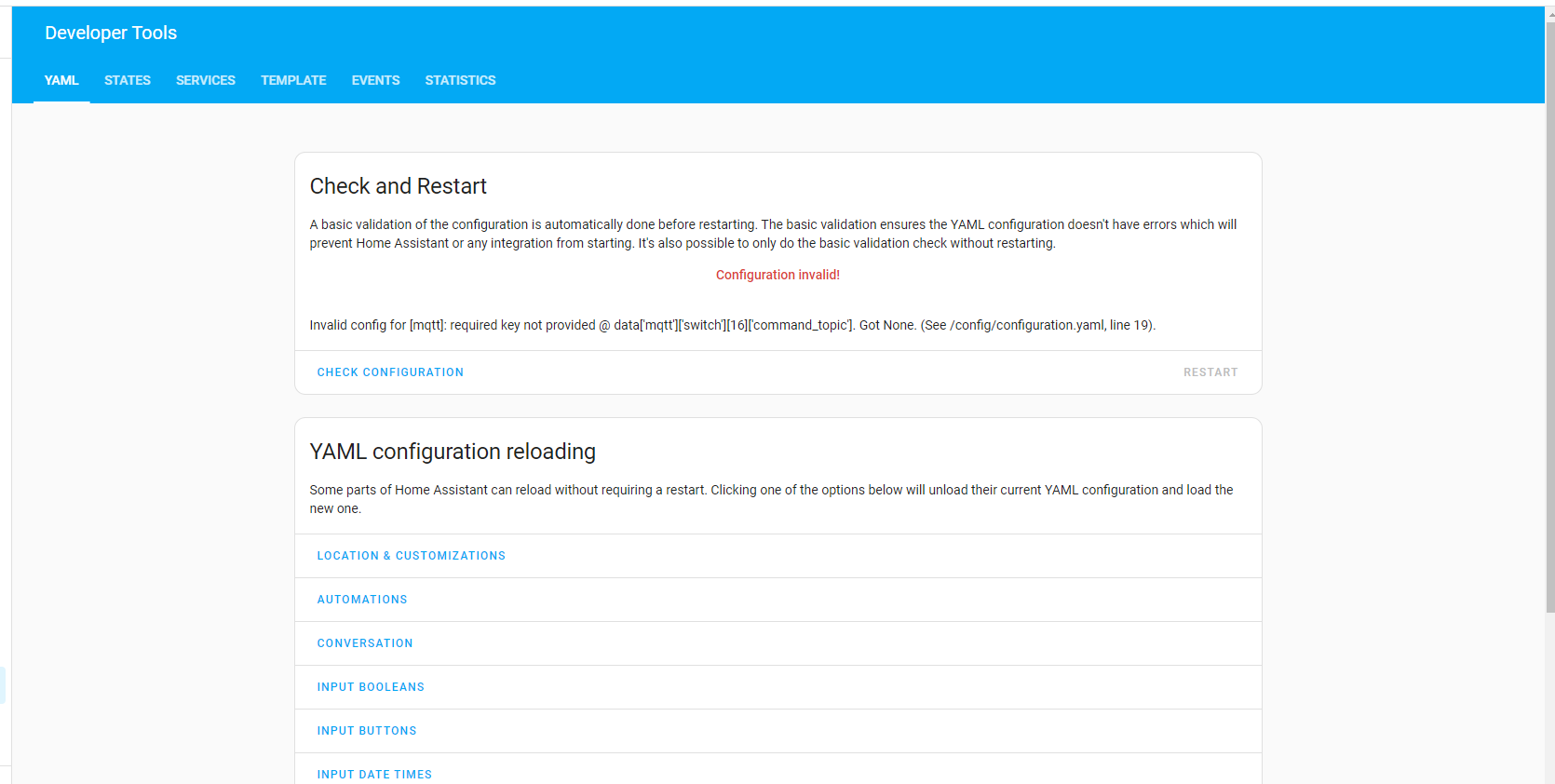

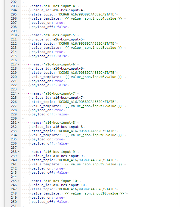

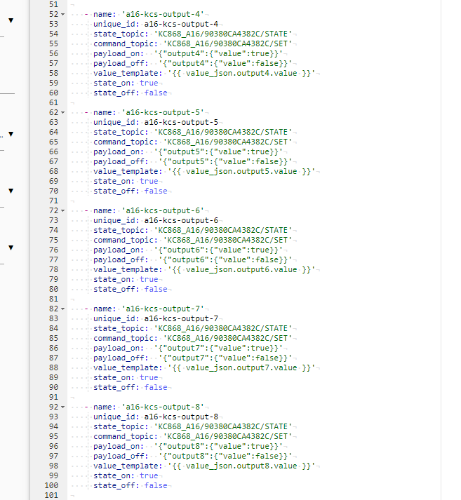

I fixed it but it still doesn't work Sad

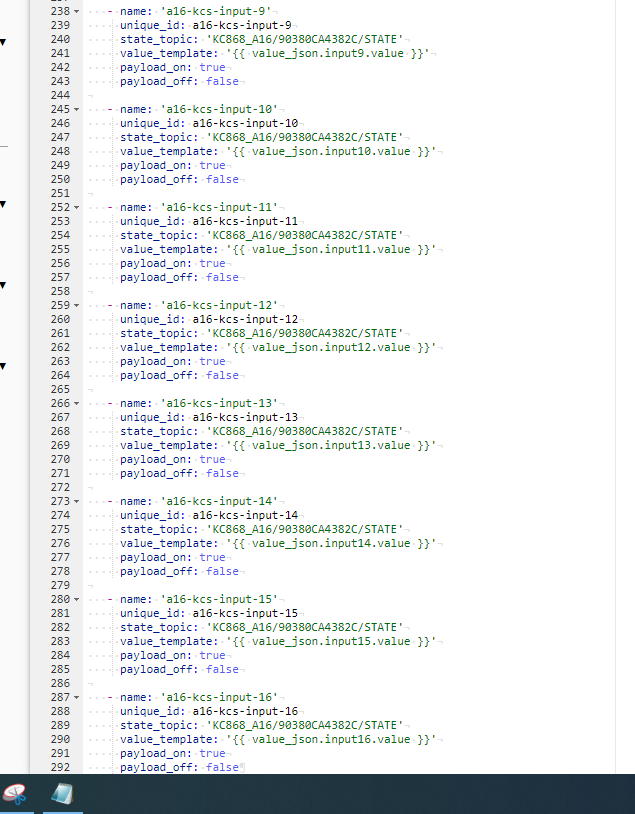

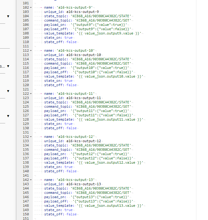

.txt   kc.txt (Size: 9.16 KB / Downloads: 608)

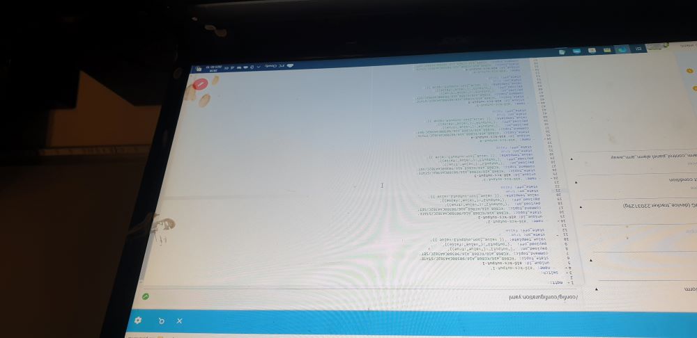

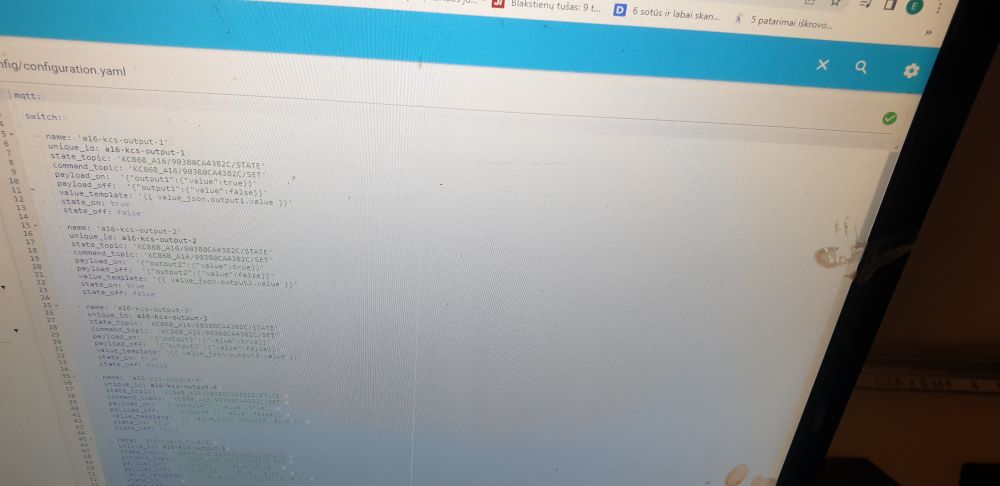

your photo is not clearly, please use the screenshot tool, i think you just check with the home assistant error message.
(02-14-2023, 12:16 AM)admin Wrote: your photo is not clearly, please use the screenshot tool, i think you just check with the home assistant error message.
I upload my file
.txt   KC868-A16.txt (Size: 9.16 KB / Downloads: 571)
I upload my file
 Can you help?
