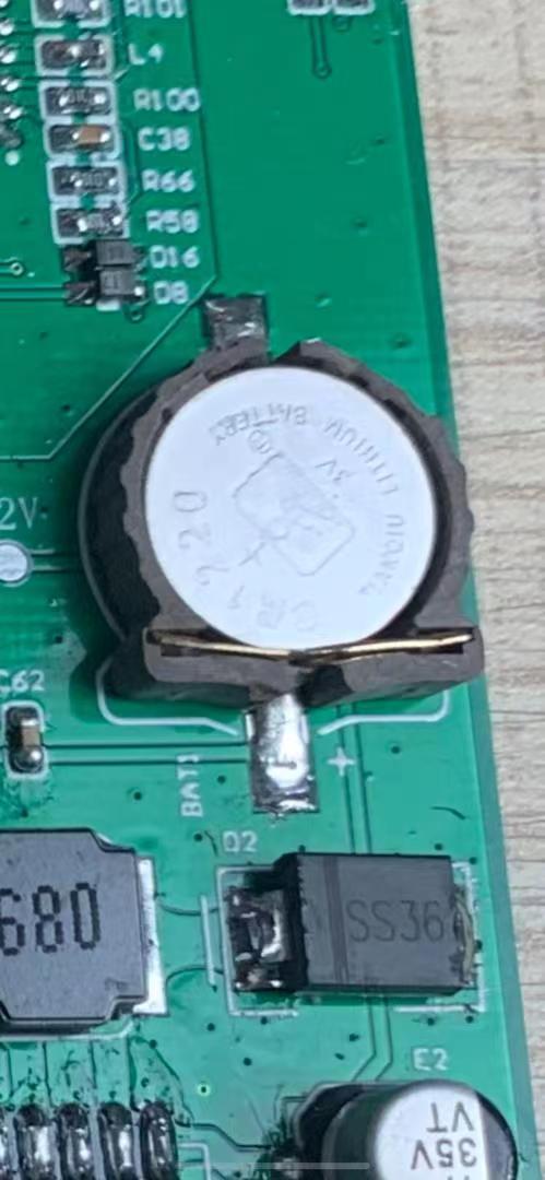

My COLB mini as desire operate, except internal clock/time will be back to default setting when power supply off and on again
This condition cause we always re-set up the time after power shutdown.
Could you any idea to eliminate this problem?

open metal box, install a battery on PCB board socket, that is use for save clock. because the product is send by airplane, so we can't install battery into the box.
