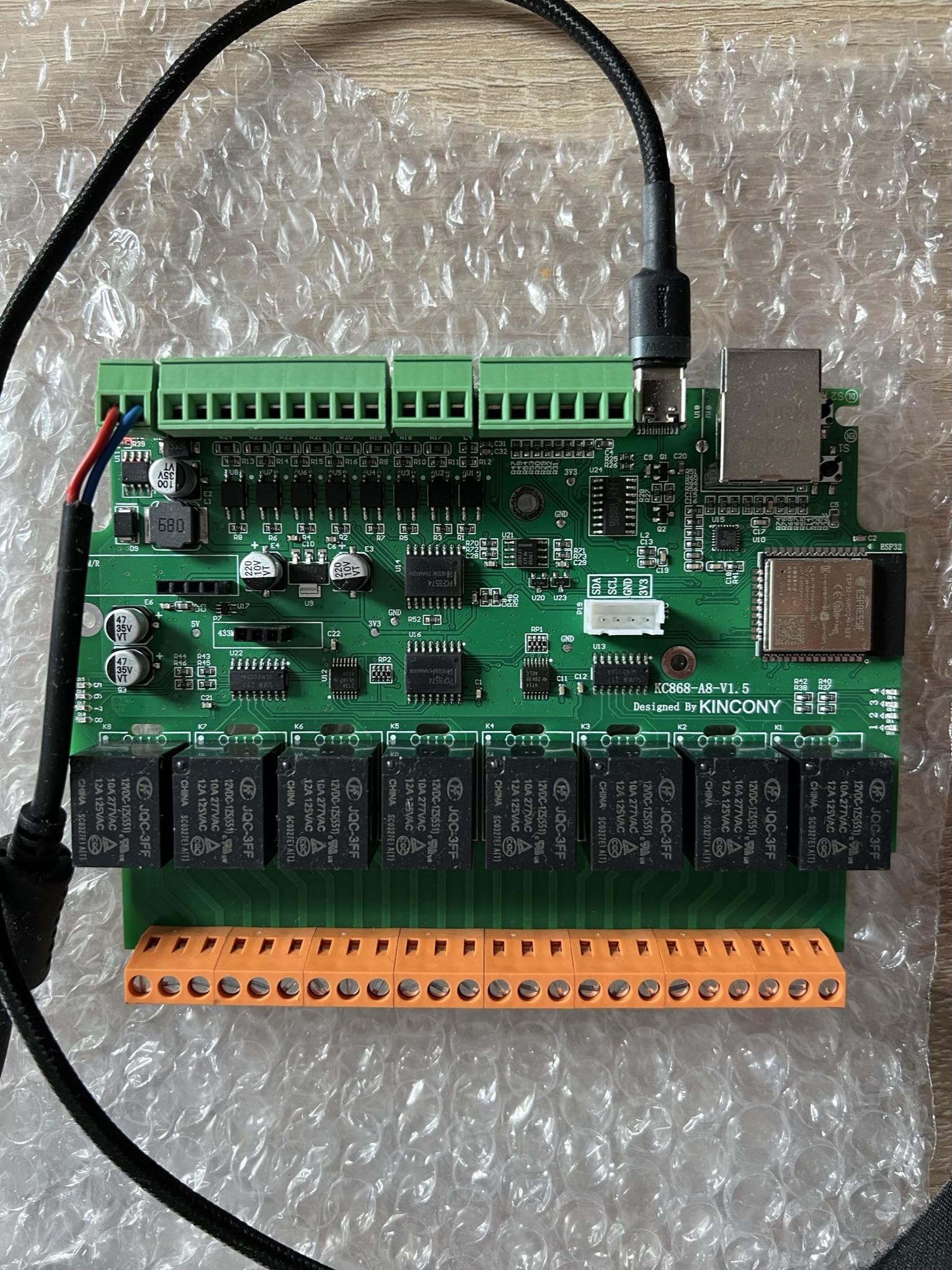

Hello.I have a panel mentioned in the title.I would like to use it in Homeassistant with tasmota firmware.However, the template code I found for it does not work.Could you help me with a suitable code?I would like to use the inputs and outputs and I would also like to use a temperature sensor (DS18B20).Thank you very much
KC868-A8-V1.5

if you want to use home assistant, suggest use by ESPHome, here is config yaml file:
https://www.kincony.com/forum/showthread.php?tid=2367 all KC868-A8 software and document you can see here: https://www.kincony.com/forum/forumdisplay.php?fid=23

(03-27-2023, 05:27 PM)halaszlacii Wrote: I tried using this template, pasted it in but I just didn't see anything. please use ESPHome config yaml file, not use the tasmota config.

i have given you this link: https://www.kincony.com/forum/showthread.php?tid=2367
it just directly to use, only need replace the static IP by yourself. replace DS18B20 address by yourself. you will see your esphome LOG output which DS18B20 sensor scaned, then replace in your yaml file is ok.
