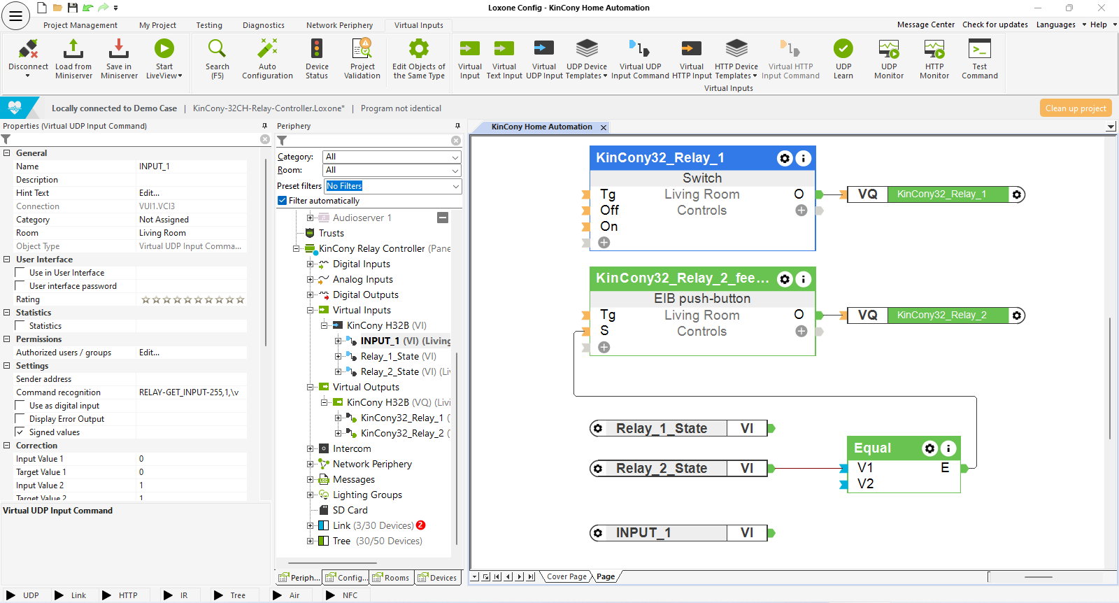

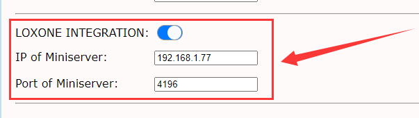

support integrate to Loxone Miniserver system by UDP command directly. Because when relay state and switch state feedback by HTTP command, Loxone need >= every 10 seconds for update, it's slowly. Now we developing new firmware feedback state by UDP command, it's fast. If you want to add to Loxone Miniserver, just enable option for "LOXONE INTEGRATION", then fill the Miniserver IP and Port.
