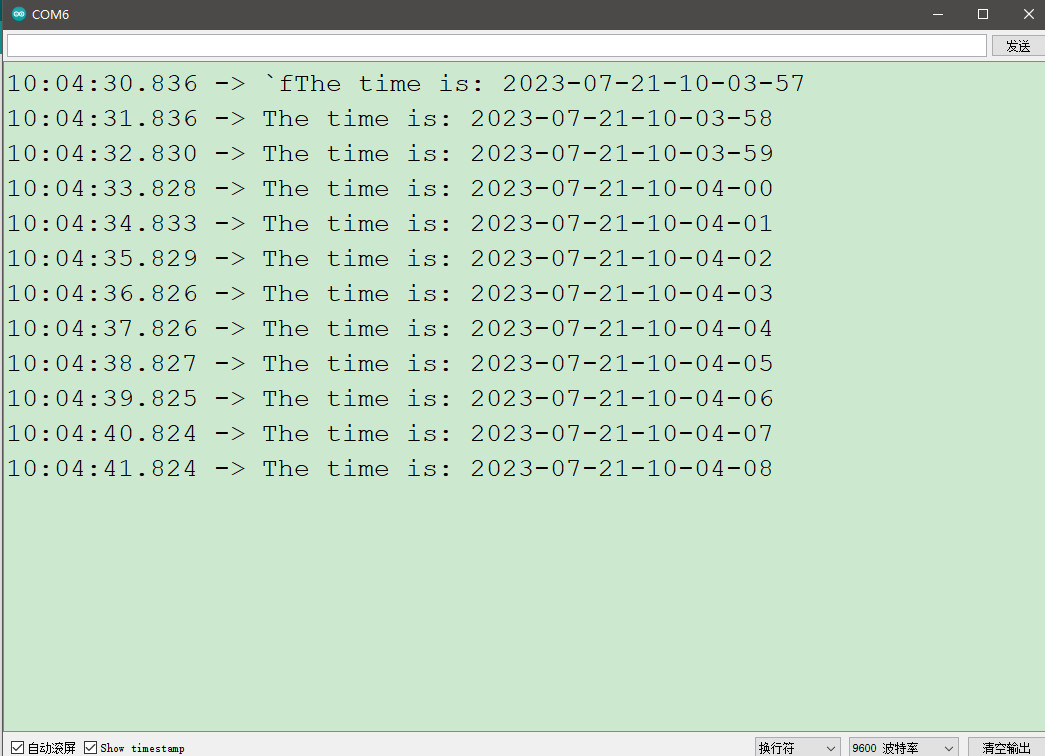

1.download the code the serial port print the time
2.power off and install CR1220
3.power on and read the time again(before power off the time is 10:02:45,and power on the time is 10:03:57)

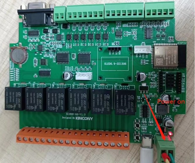

what's your battery voltage now?
when you intsall or change battery, do you have turn OFF the power of board? it should turn OFF power , install battery, power on board again.

After checking the DS1307 datasheet, I found a note mentioning the chip malfunctioning when using a diode in series with the "Vbat" pin. I removed diodes D5 and D7 from the board, and put a Jump in place of D7, and now it's functioning normally.
