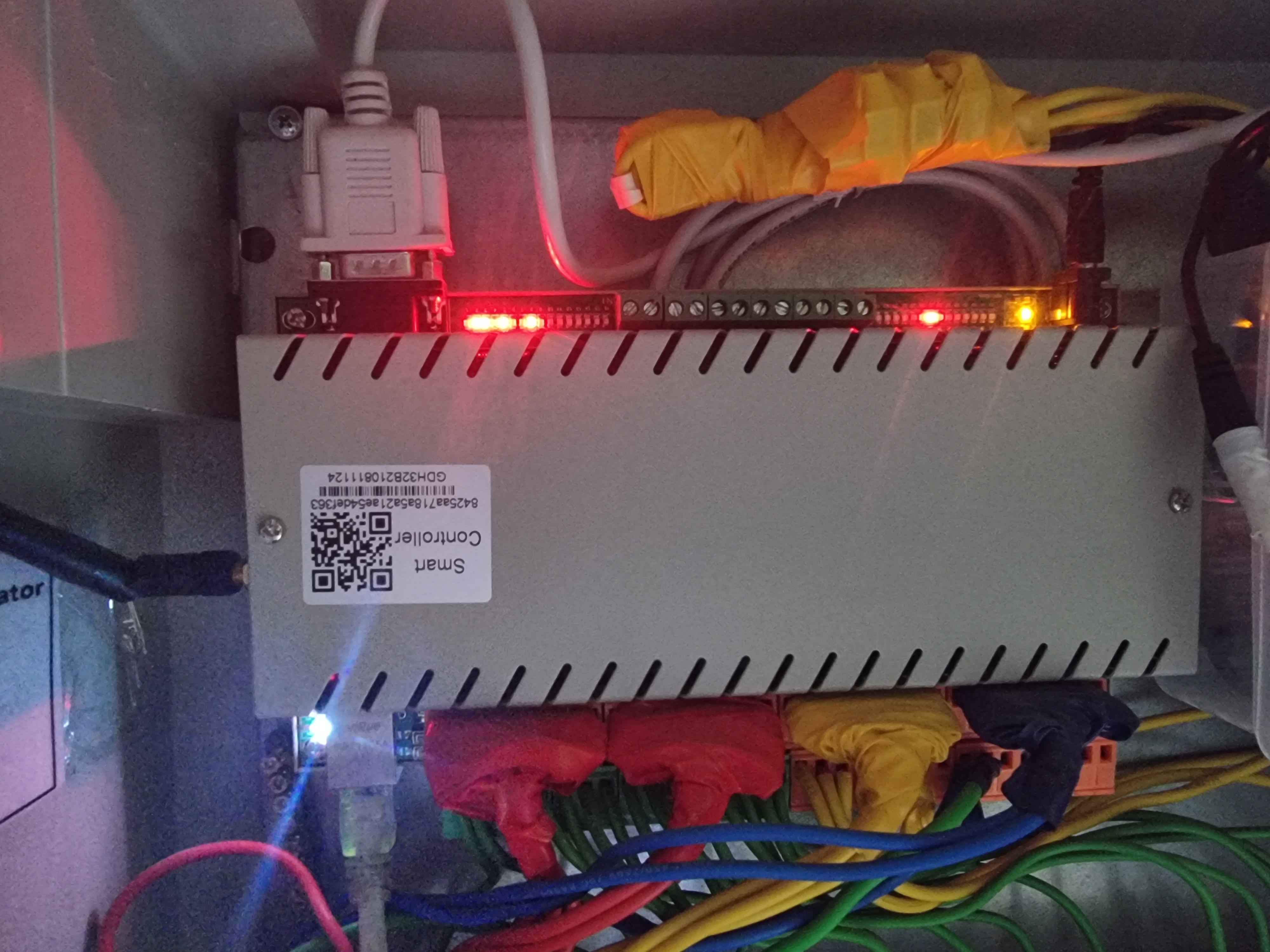

I can't control H32B
It is not responding neither by terminal switchboard push button nor using ip address of controller.

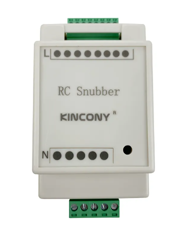

did you connect the RC snuber at the output? if you don't add this one ,the H32B will suddenly stop work when you control it ,you should restart the power every time

Please review our previous discussion regarding RC snapper.
https://www.kincony.com/forum/showthread.php?tid=1700
