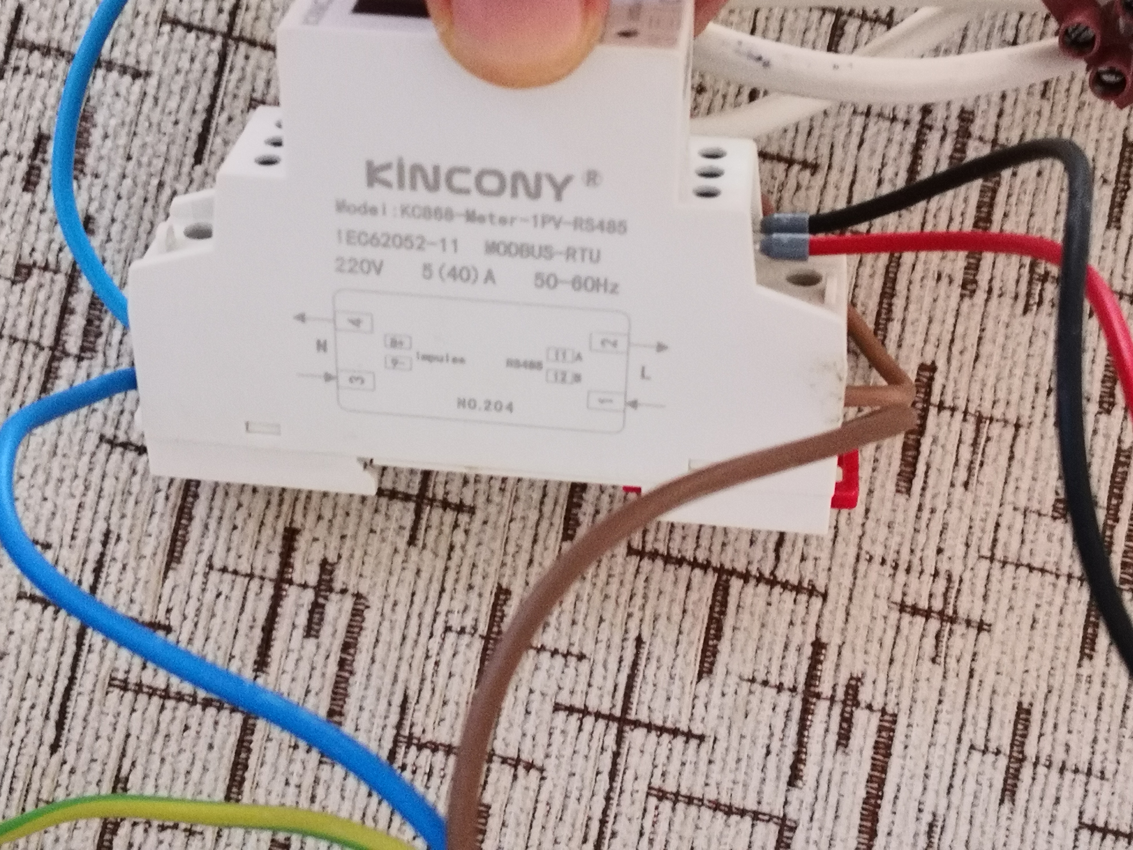

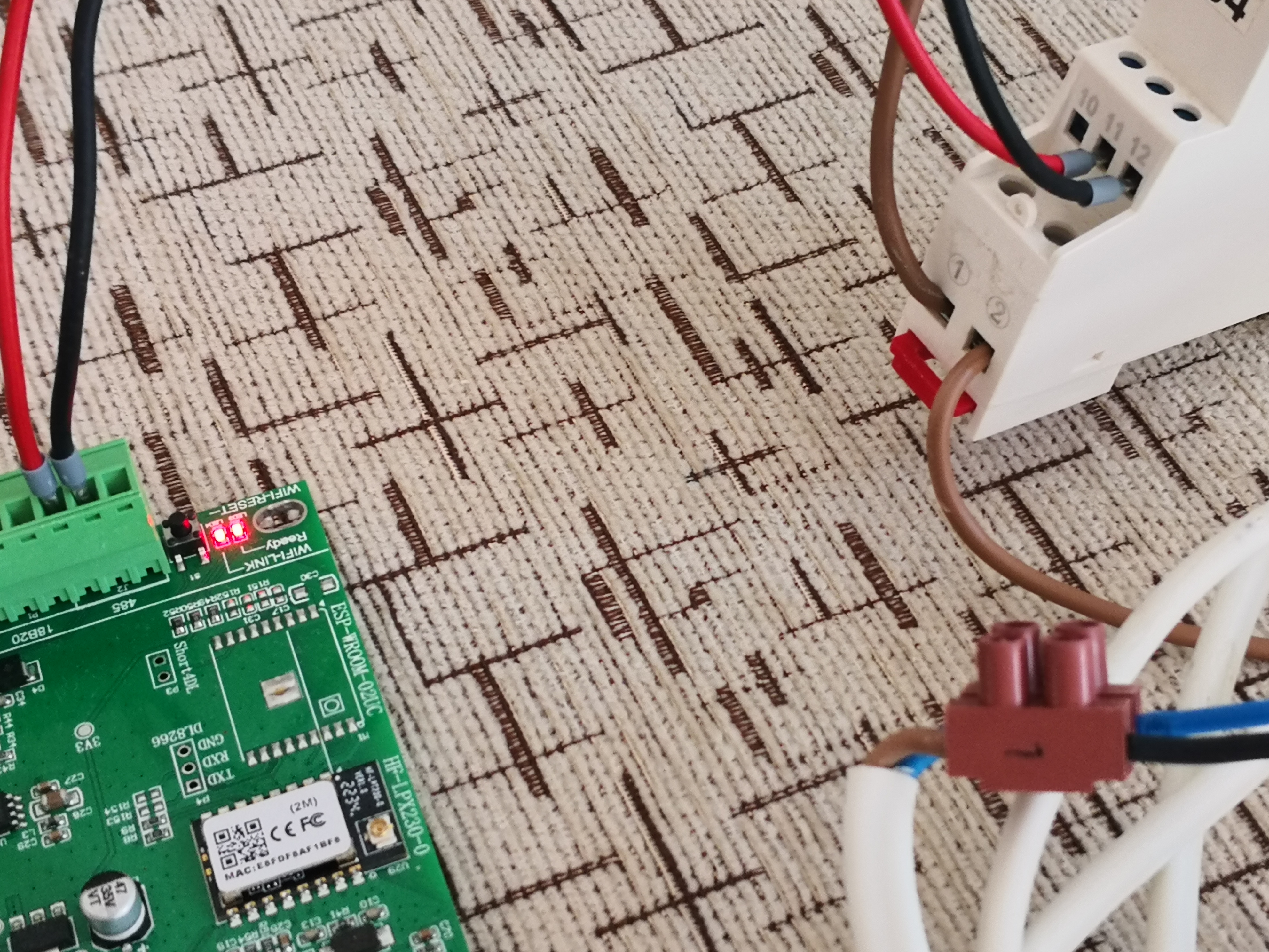

Sorry for late reply. Attached photos from connections and meter ID. I've triple checked every cable connection. All good.

the address of your Meter is 204  print on the side .you should set the address  on the software
I know the address is 204. I'm using this address. The problem is that when I click on read in Kincony SCB_V1.0.410.504 software nothing happens. All values remain 0. The address is set to 204, successfully connected to the board still all data remaind 0 on meter read.

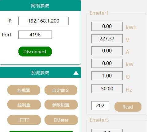

upload your KC868-COLB pc software setting screen photo.

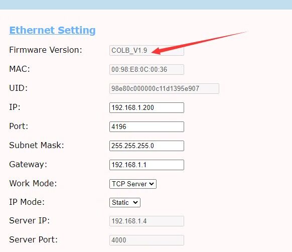

i have tested by COLB firmware V1.9 , it's ok, if you MUST need to use power meter, you can use V1.9 firmware firstly.
we will fix this problem in next COLB firmware version update.
