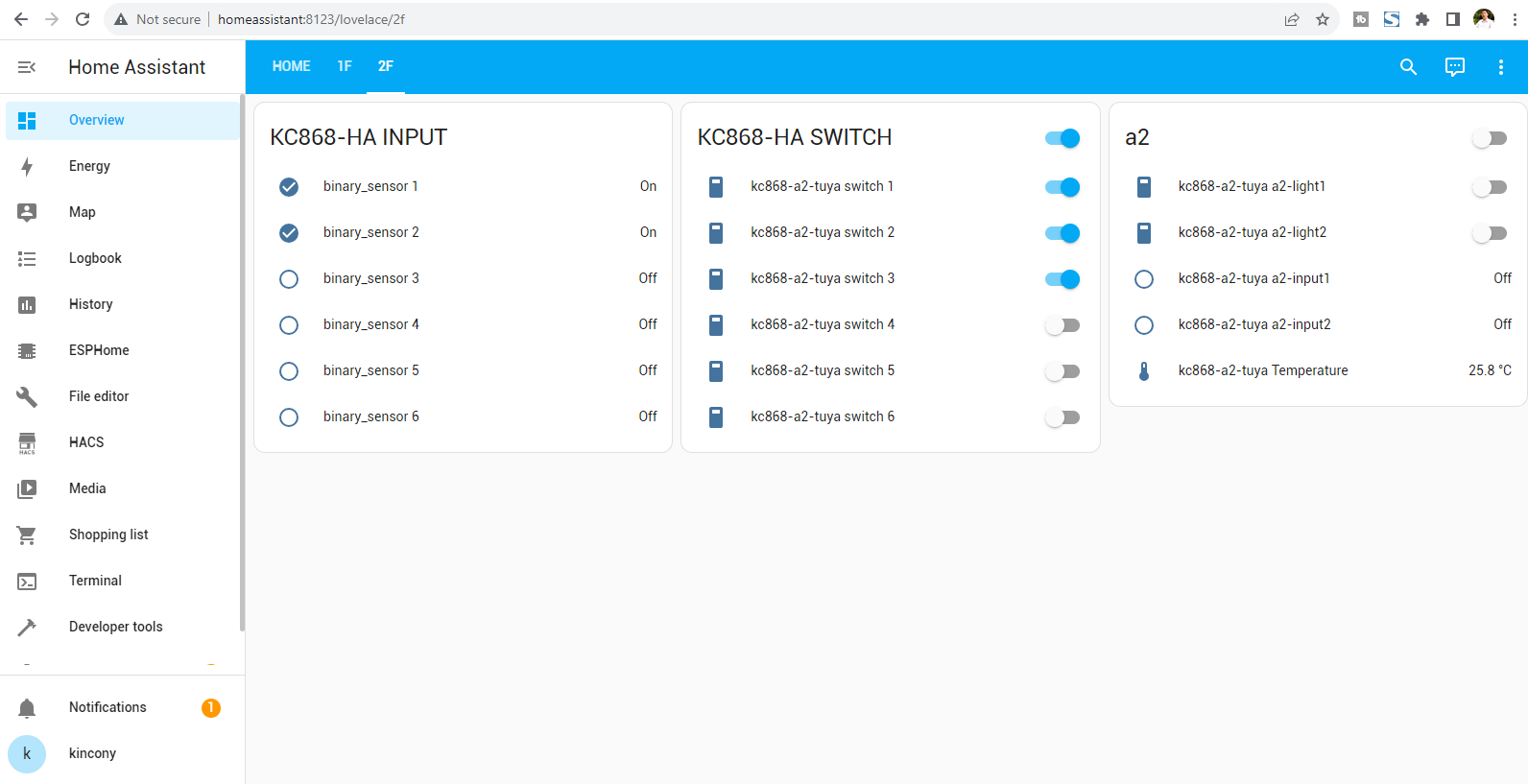

KC868-HA RS485 INPUT & OUTPUT plugin for ESPHome
Use this plugin for ESPHome. you can add everyone KC868-HA board with 6 digital input ports and 6 digital output ports to home assistant. "digital input" can use for switch panel buttons or dry contact sensors. "digital output" can use for LEDs or extend relay module (need add driver).
how is config yaml file demo details: https://github.com/hzkincony/esphome-kc868-ha

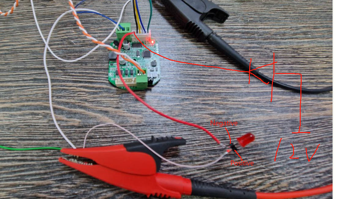

Good afternoon, please tell me the problem I have is that the output switches do not work. I configured everything as in the description on the guide hub. The inputs work in the Home assistant, but the outputs do not react, nothing, what did I do wrong?

how do you test your output port? can you take a photo?
Video of input working and output not working I can’t send the video here’s the photo

Hoi Kataktok,
Be aware that the output of the kc868-HA is active - LOW !

[Image: detail1_03.jpg]
test output as this way, this is KC868-HAv2 PCB, but v1 PCB is same.
I downloaded the firmware from here https://www.kincony.com/forum/showthread...t=kc868-ha  .Now I changed it to version 106 but it still doesn’t work, the state doesn’t change. I tried the same thing with 2 boards. Help please, what's wrong? what am I doing wrong?

check the pin is right
