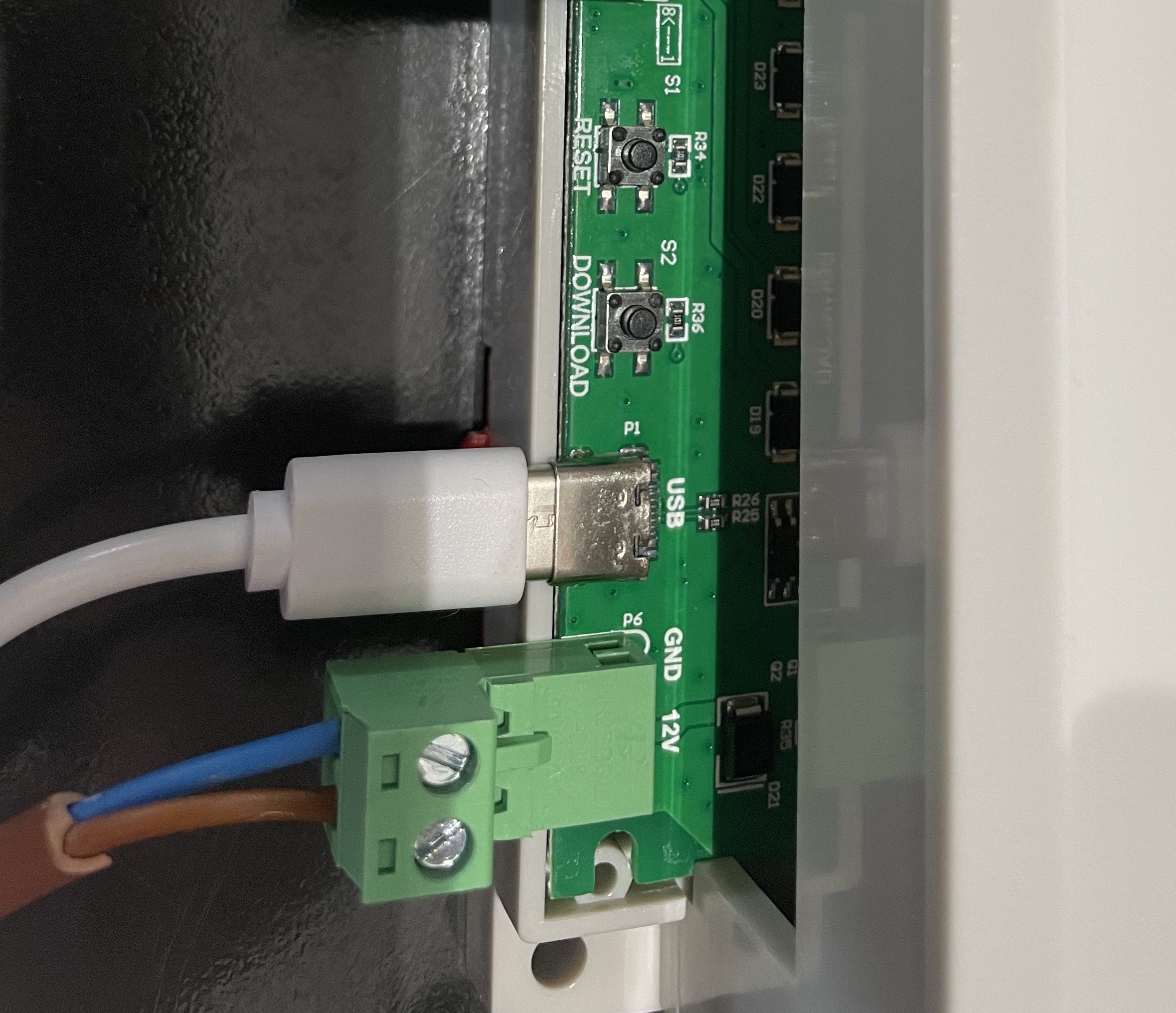

I bought a KC868-A16 recently but that seems unresponsive.
I can see it sends periodic GARP with ip 192.168.1.200, power and Ethernet leds are on, but It is not detected by KSC firmare tool through serial/USB or UDP SCAN through the network.
Is there any way to change the Ip? does it have a web interface that can I access to do that?
Thanks

open the plastic shell, take a whole photo of your A16 PCB.
