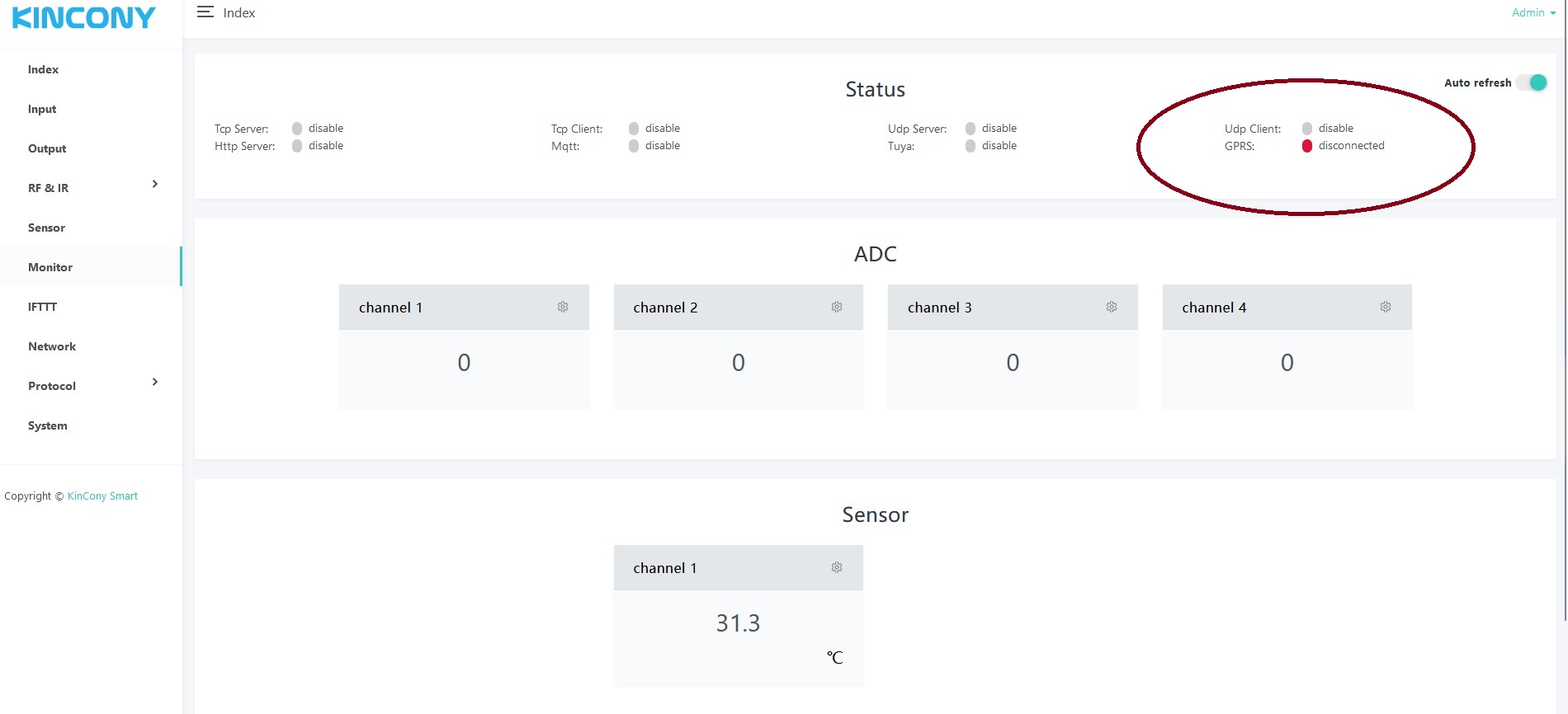

Recently I bought KC868-A8M with SIM7600 module and Installed the latest KCS firmware (KCS_KC868_A8M_V2.1.9). I enabled the GSM on the network settings page. But, I'm getting "GPRS : disconnected" on monitor page. Try to clicking "Phone test" but I'm getting "error".

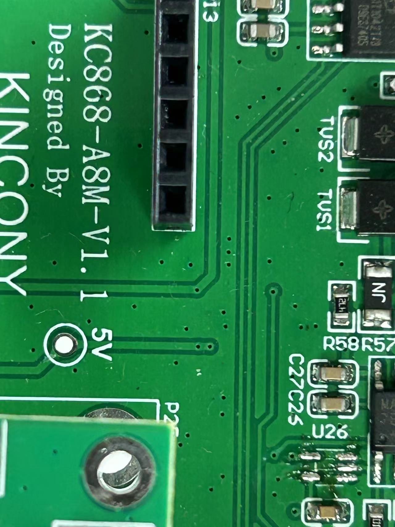

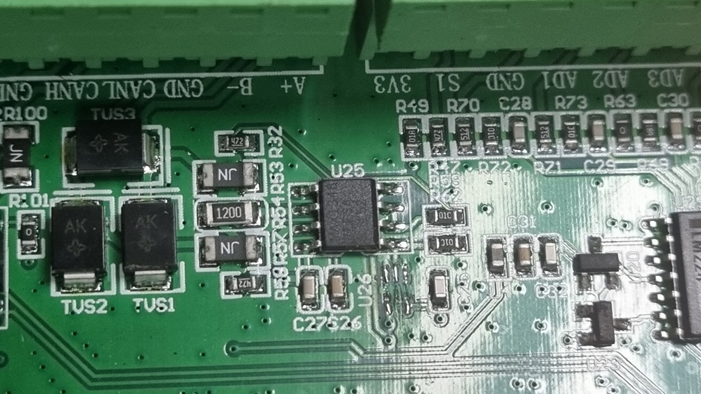

do you want only use by 4G module, not need to use RS485 , right?
because RS485 and 4G module use same serial port. if you not need to use RS485, you need remove IC:U26 (74LVC1G125) . Then you can use 4G module.

(02-23-2024, 06:09 AM)admin Wrote: do you want only use by 4G module, not need to use RS485 , right?
we have update KCS A8M firmware for V2.2.4 to solve the 4G module problem. just download it directly to use.
Thank you very much for your quick response and support. I purchase several SHT20 RS485 Modbus modules to get samples from several places. Anyway, I will use an alternative.
Just remove the U26 IC and upload the given firmware. But have the same error.

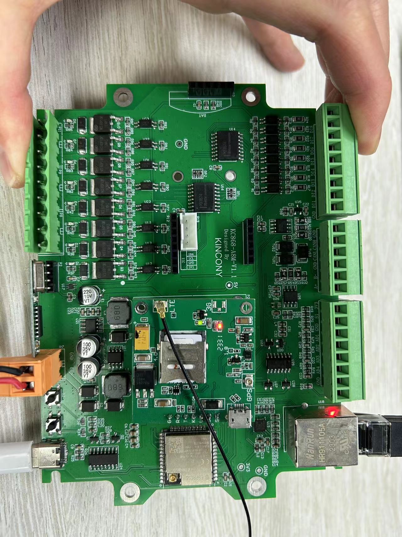

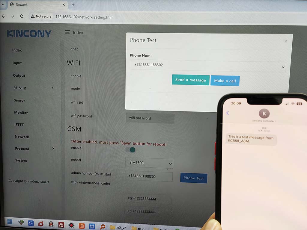

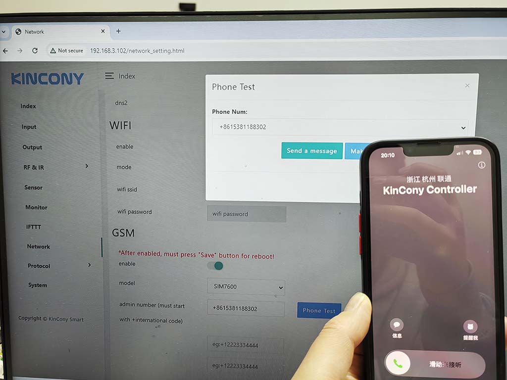

we have tested A8M remove U26 chip by KCS v2.2.4 firmware . it's OK.  Note: after you enable GSM, press SAVE button. then you need power off->on of your A8M board. when power on again, then use "Phone test" button to test "SMS" or "CALL".
test with CALL
test with SMS
