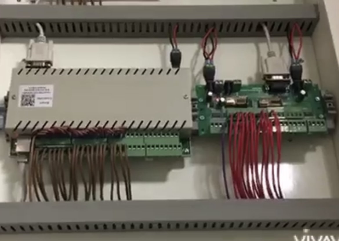

I have a kc868-H32L controller.
I programmed it to be in a motor mood.
When i turn on relay(1 or 2 or 3…..or 32) by button switch module, relay (1 or 2 or 3…..or 32)will be on for 1 minute, and after that will turn off automatically.
If (for example) i turn on relay1, then i turn on relay2, so relay1 will be OFF (because control is in motor mood)
Now, if i do all the above by kincony smart home app, I don’t get same results. Which means:
➡️ if i turn on relay1, then relay1 will be on forever, and don’t turn off after 1 minute automatically.
And if i turn on relay1, and then turn on relay2, the relay1 will not turn off and it stays turned on.
Why is that❓
Is there any solution ❓

take a photo of your controller , i want to see how you wire. do you use switch terminal board? if you are using switch terminal board, you can set for "MOTOR" mode.

Another question:
My H32L is in motor mood,
Why when i turn on for example relay1, by switch terminal board, then the relay will be OFF after 1 minute, but if i turn it on by kincony smart home app or by tuya app, it will be ON all the time, till i turn it OFF(not after 1 minutes)?
Now, i know that i can put a timer by tuya app, but i want to understand :
1. Why the relay turned OFF after 1 minute just by switch terminal board?
2. If the H32L controller set in motor mode, shouldn’t the relays turn OFF after 1 minutes no matter the commands source? Which means (switch terminal board, kincony smart home app, tuya app, Kbox app, etc…)??!!
Posts: 10,484
Threads: 1,560
260
because the switch terminal board work as MOTOR mode for shutter or curtain. if people forget to STOP motor, it will auto off after 1 minutes to protect motor.
i suggest you replace switch terminal board with KC868-AK board, so that can set every buttons logical by yourself.
