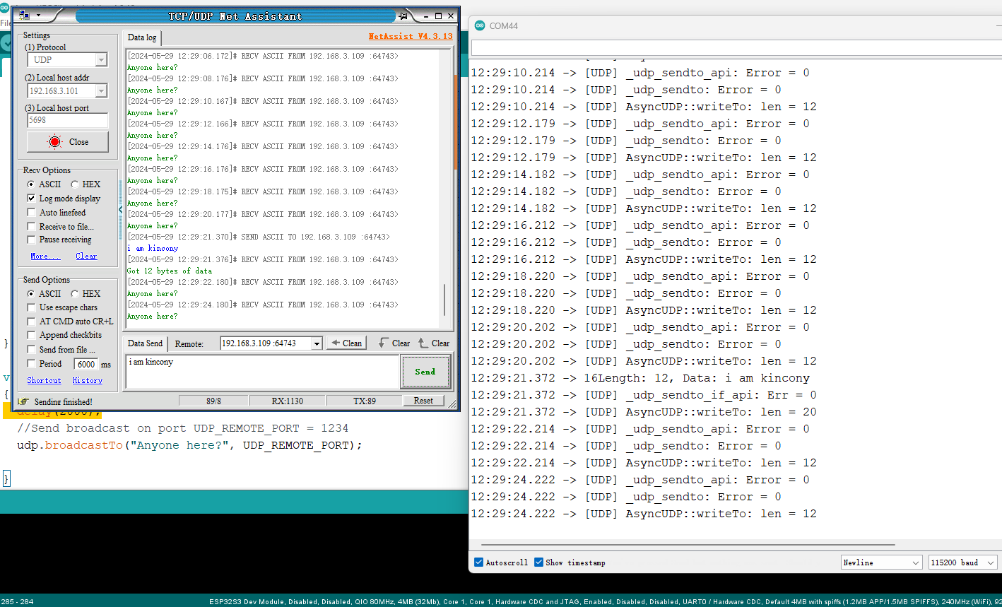

Arduino source code for A32 Pro - UDP with Ethernet chip W5500

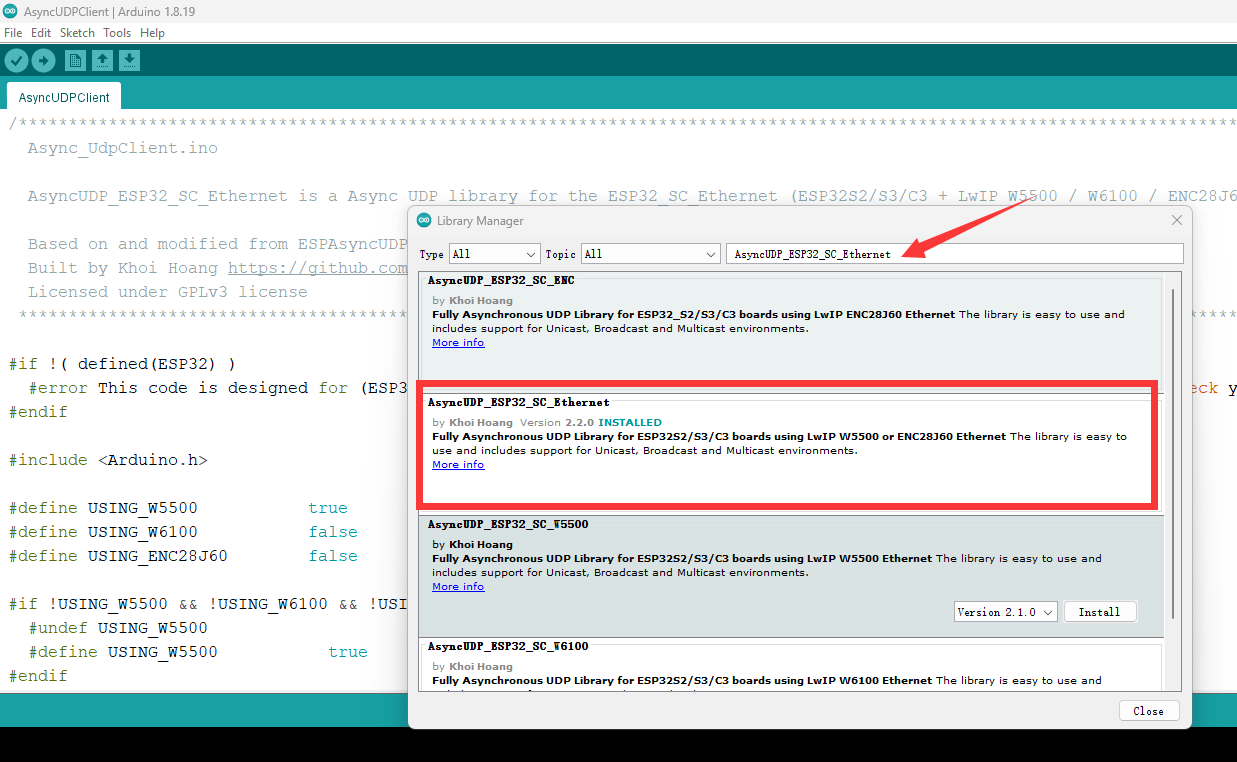

before run code, you need to install "AsyncUDP_ESP32_SC_Ethernet" arduino library.

  if (udp.connect(remoteIPAddress, UDP_REMOTE_PORT))
    Serial.println("UDP connected");
    udp.onPacket([](AsyncUDPPacket packet)
      parsePacket( packet);
    //Send unicast
    udp.print("Hello Server!");
void loop()
  delay(2000);
  //Send broadcast on port UDP_REMOTE_PORT = 1234
  udp.broadcastTo("Anyone here?", UDP_REMOTE_PORT);
