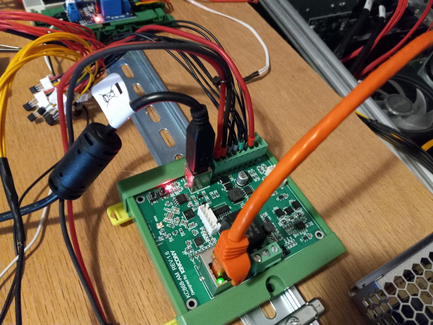

I am testing ds18b20 sensors with KC868-AM I have 8 sensors attached, 2 per input terminal.
With KCS v2.2.4 firmware I get results from at least 4 sensors. See picture.

Also tested with one ds18b20 sensor in each one of the sensor inputs with KCS v2.2.4 firmware and each individual sensor input worked.
