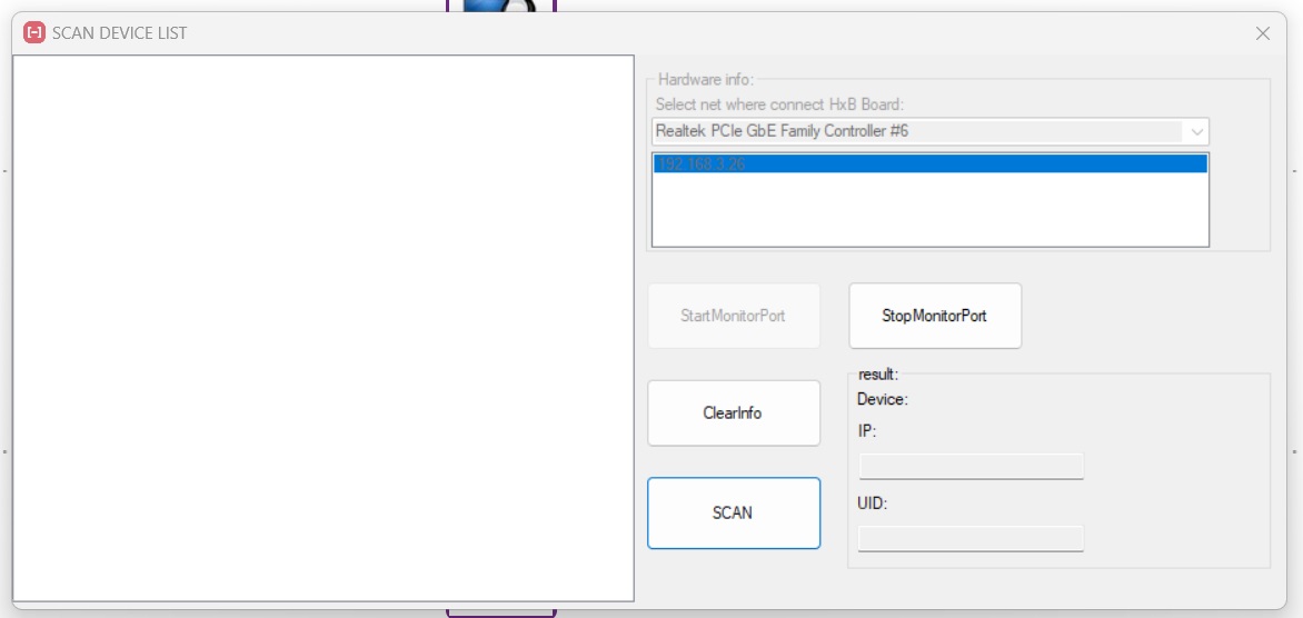

But when I try to flash v2.2.2, all appears normal, but the IP address I expect it at does not respond.
Scan tool does not detect it either.

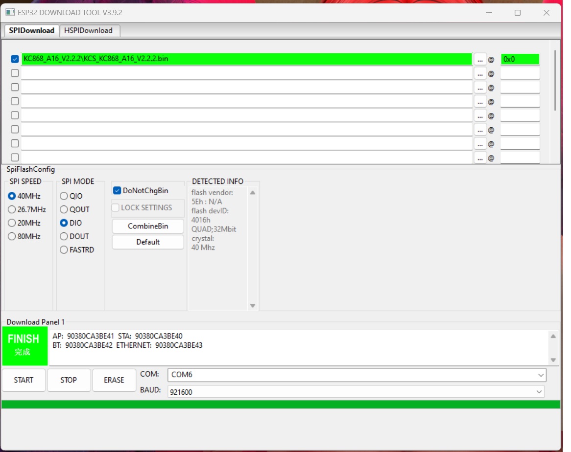

can you do "ERASER" firstly, then download firmware for v2.2.2

test this new version, whether work well.
.zip   KCS_KC868_A16_V2.2.4.zip (Size: 763.16 KB / Downloads: 753)
Nope same issue.

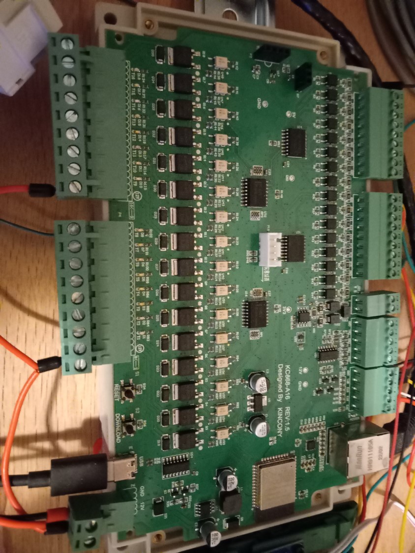

take a photo of your A16 PCB board.
Here is a picture of my board. Don't know what good it will do.
See post: https://www.kincony.com/forum/showthread...4#pid14604
V2.2.2 was working on this board in the past, but now it will not function after flashing.
ESPHOME and V2.1.9 both work just fine. Something on this board has changed that is preventing v2.2.2 or > from being detected after flashing.
