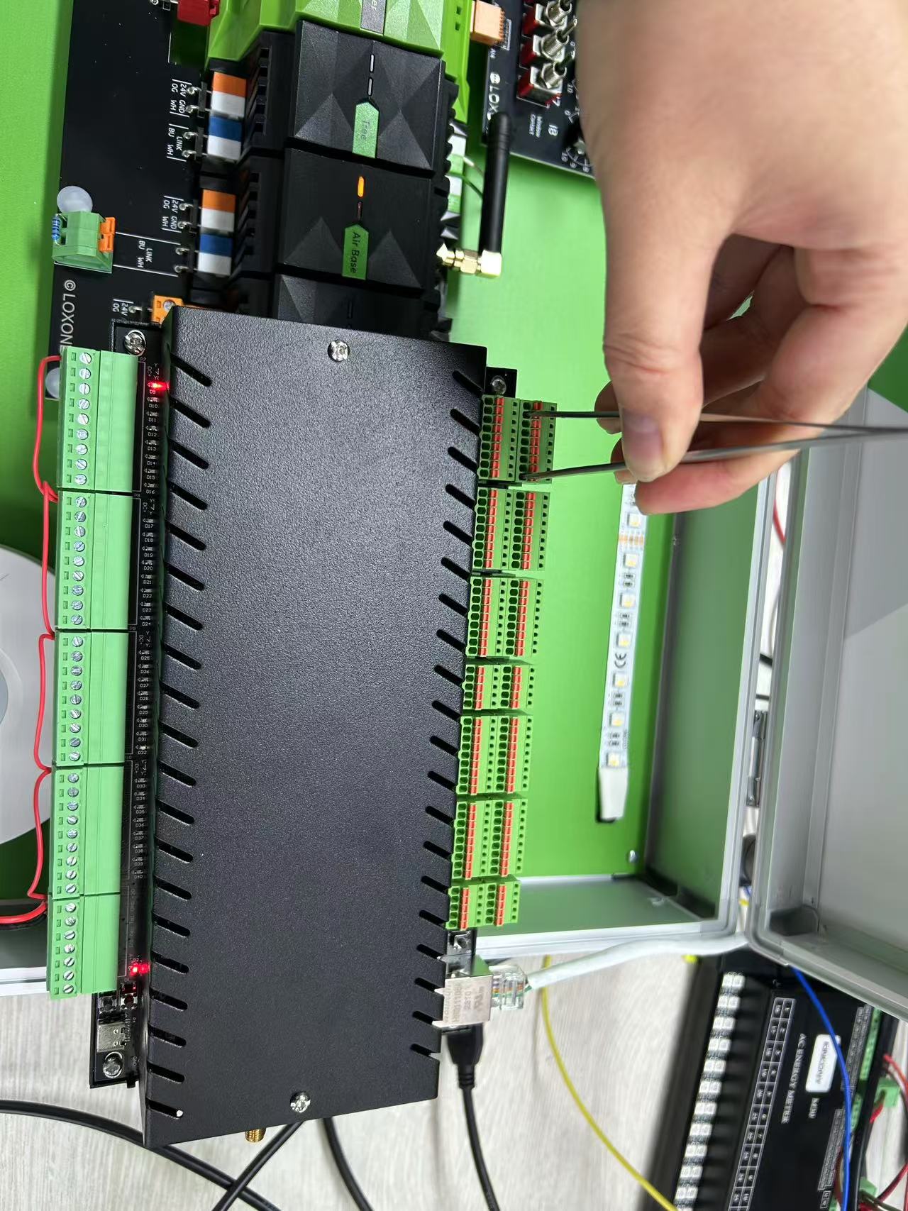

i have tessted KC868-AIO work with Loxone Miniserver, it's OK.
i have write the yaml with 1 channel output and 1 channel input demo for you. you can enable more channels for Loxone Miniserver.

turn ON output1 by home assistant web page, then Loxone will update:
trigger INPUT1 with GND:
Then will feedback to Loxone config:
Loxone project download:
https://www.kincony.com/forum/attachment.php?aid=3439
