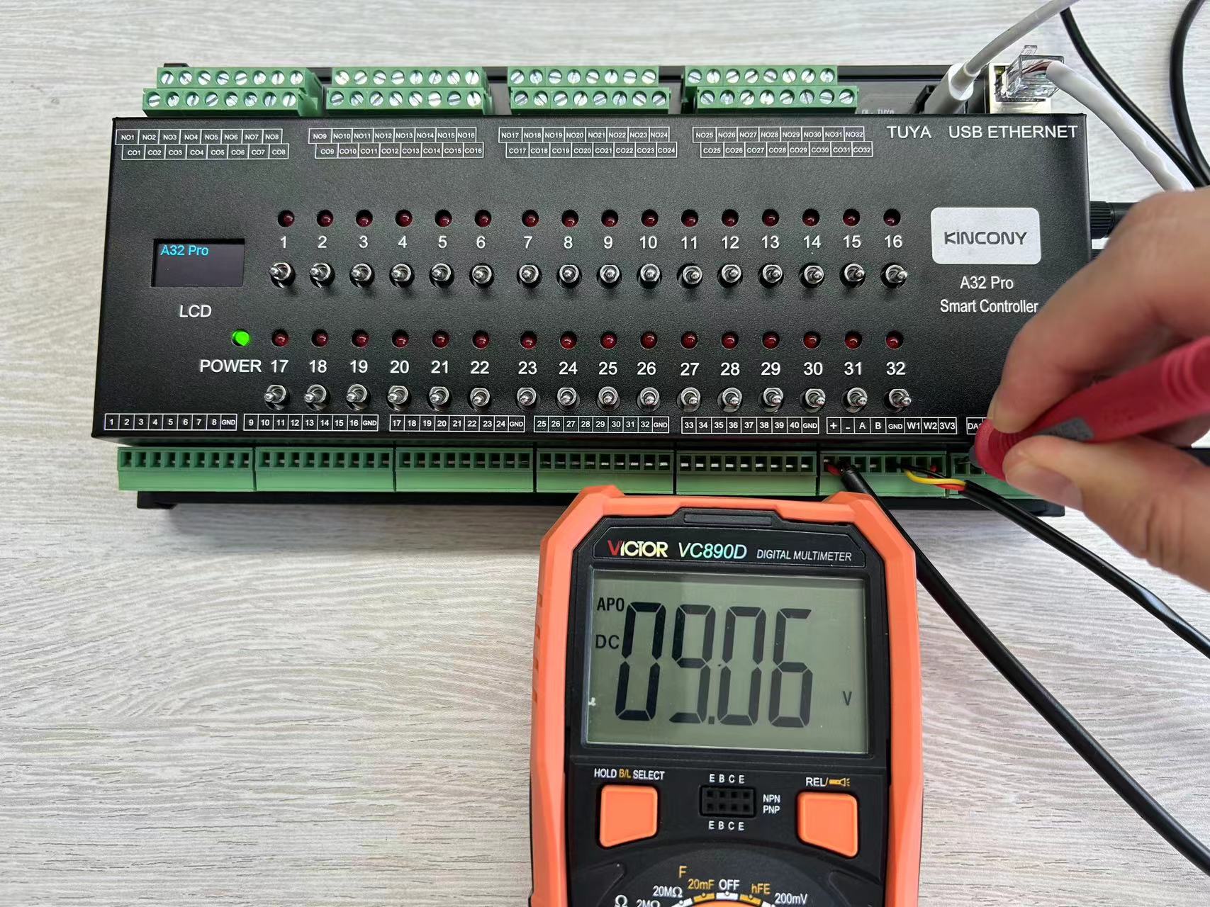

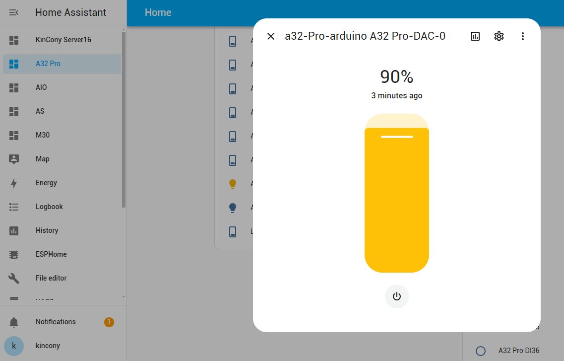

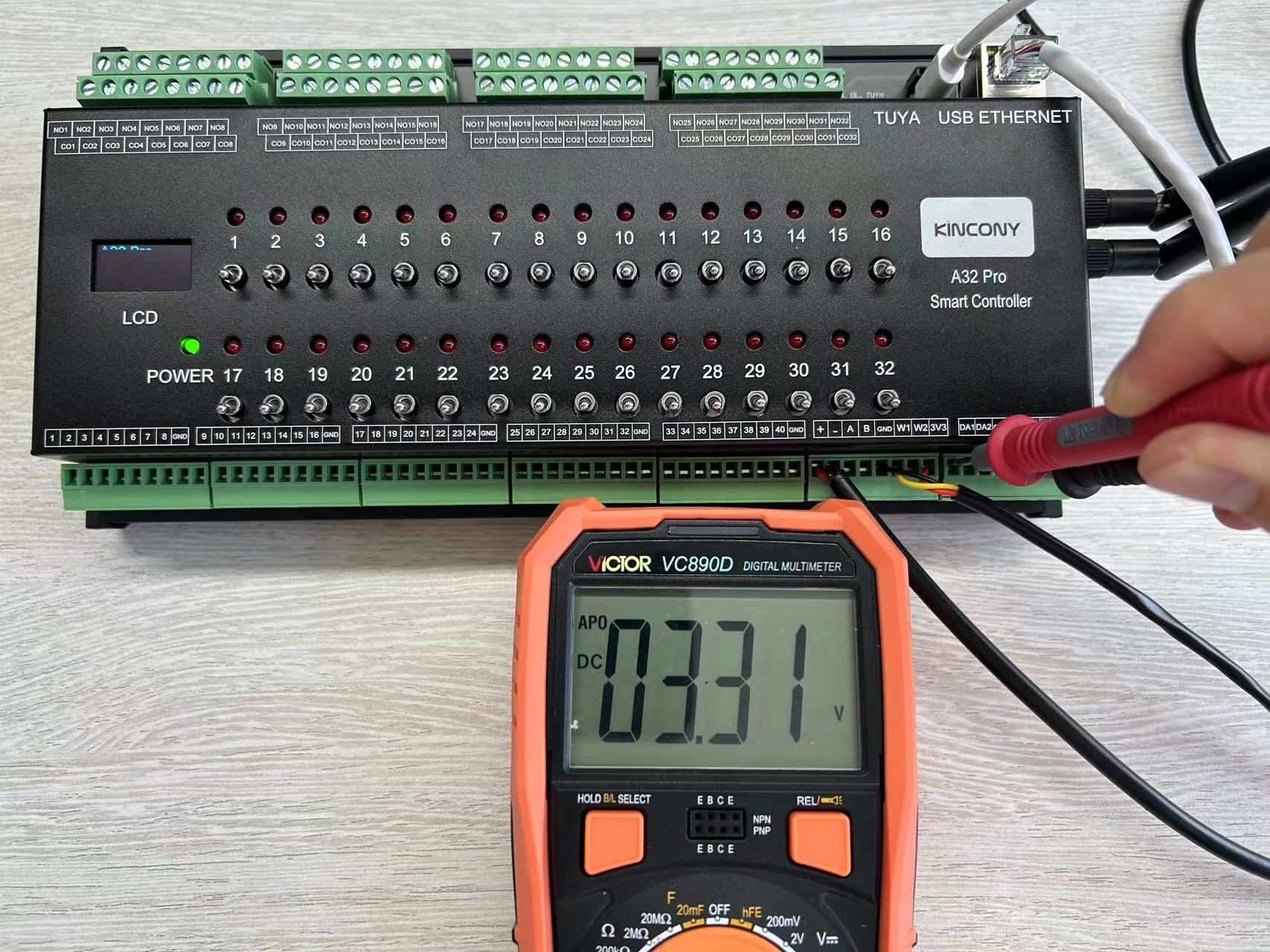

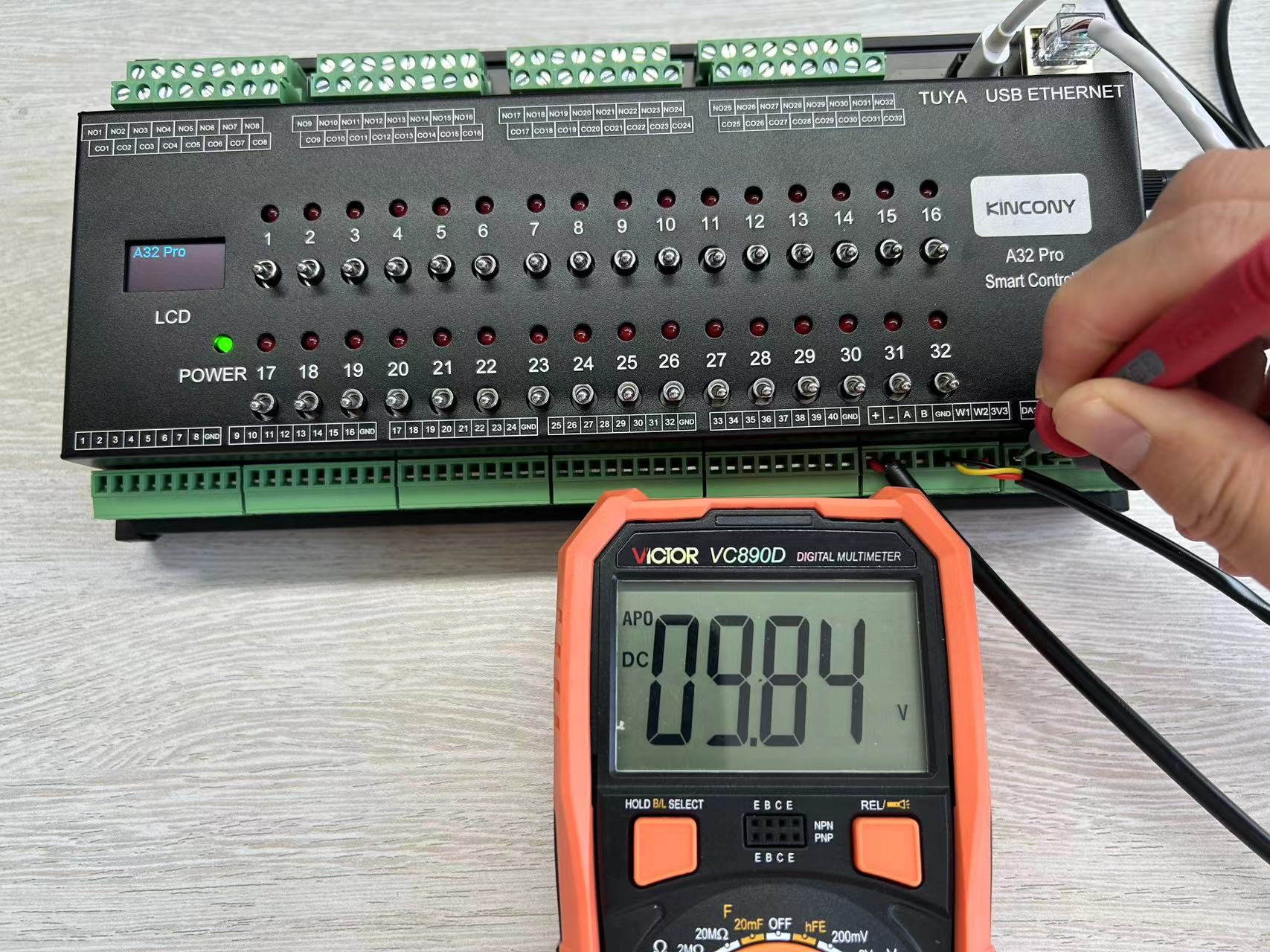

how to slove A32 Pro/A24 DAC dimmer output voltage is not linear issue
just add "gamma_correct: 1.0" to ESPHome ymal.
