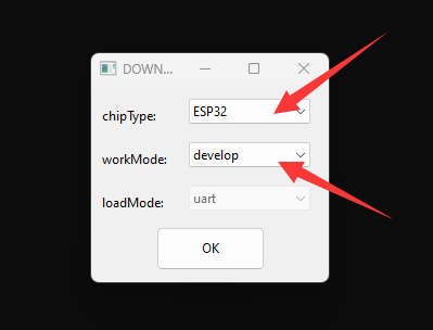

Here is "KCS" firmware for KinCony M30 AC energy meter board.
Download fimrware by USB-C cable via ESP32 Download Tool.
firmware BIN file download:
KCS_M30_V2.4.6.zip (Size: 735.42 KB / Downloads: 599)
ESP32 Download tool download link

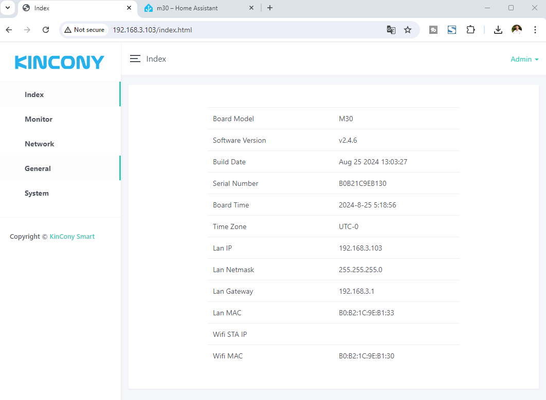

KCS firmware for M30

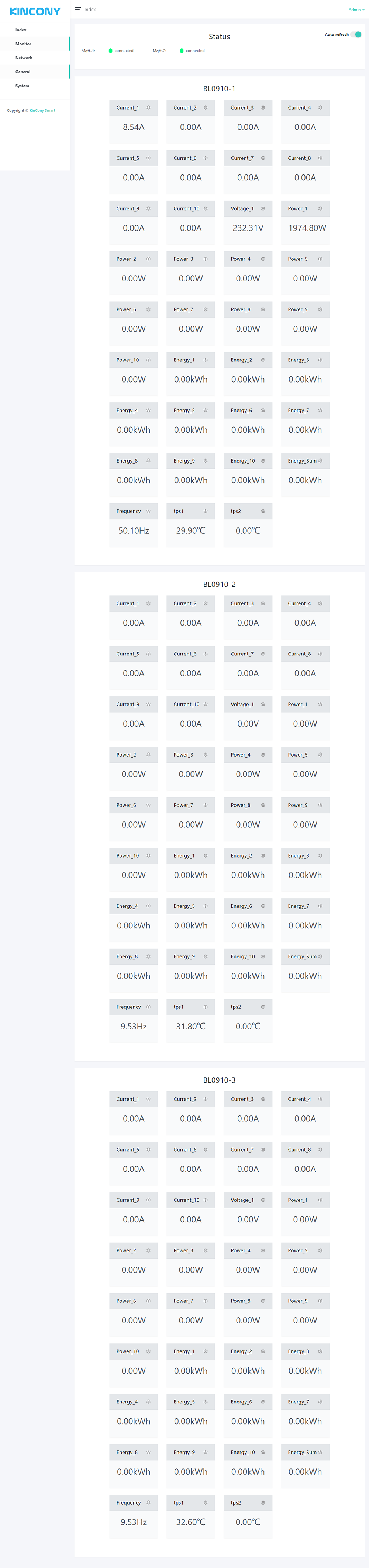

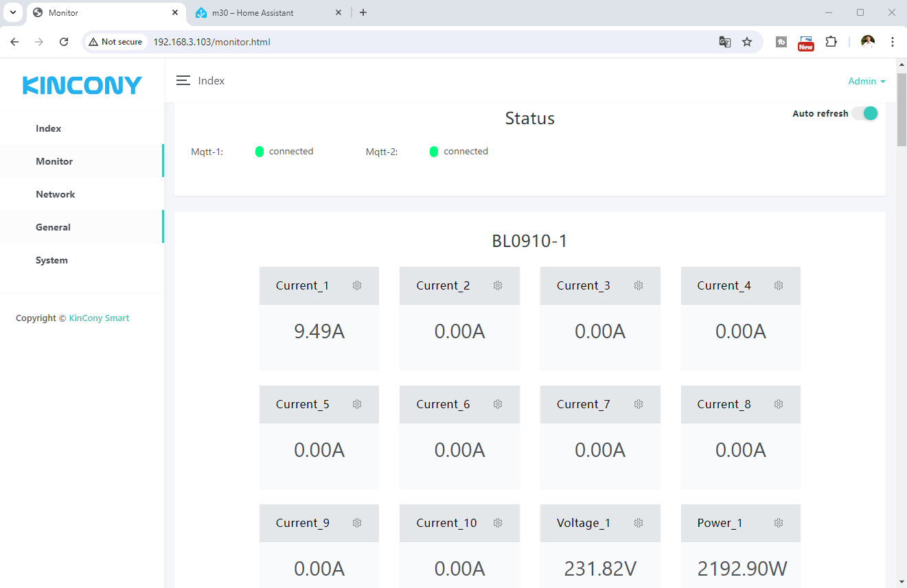

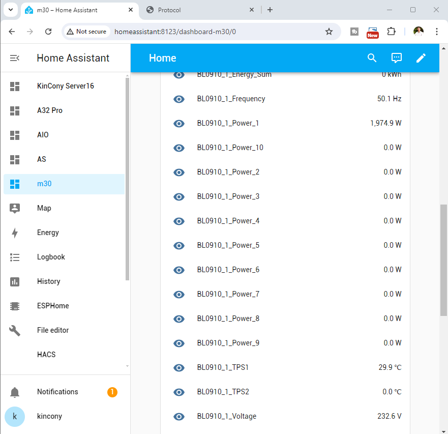

Monitor all channels for Current, Voltage, Power, Energy, Frequency, chip Temperature

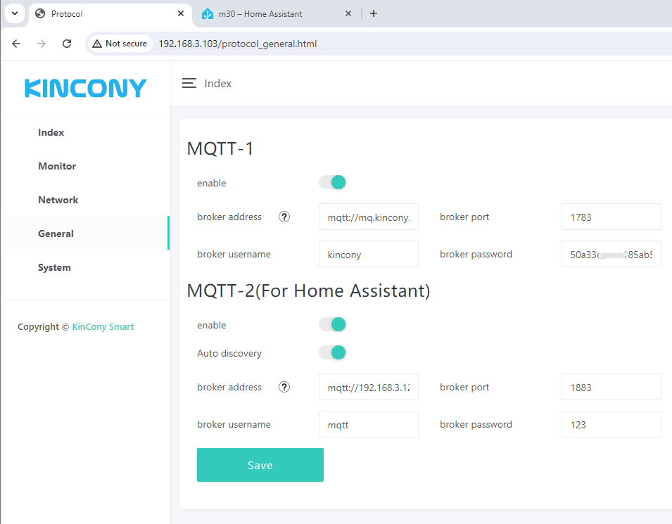

setting for MQTT-1 and MQTT-2. MQTT-1 connect to your own private MQTT cloud server. MQTT-2 use for home assistant MQTT broker. If you want to use Auto Discovery function, just enable it.

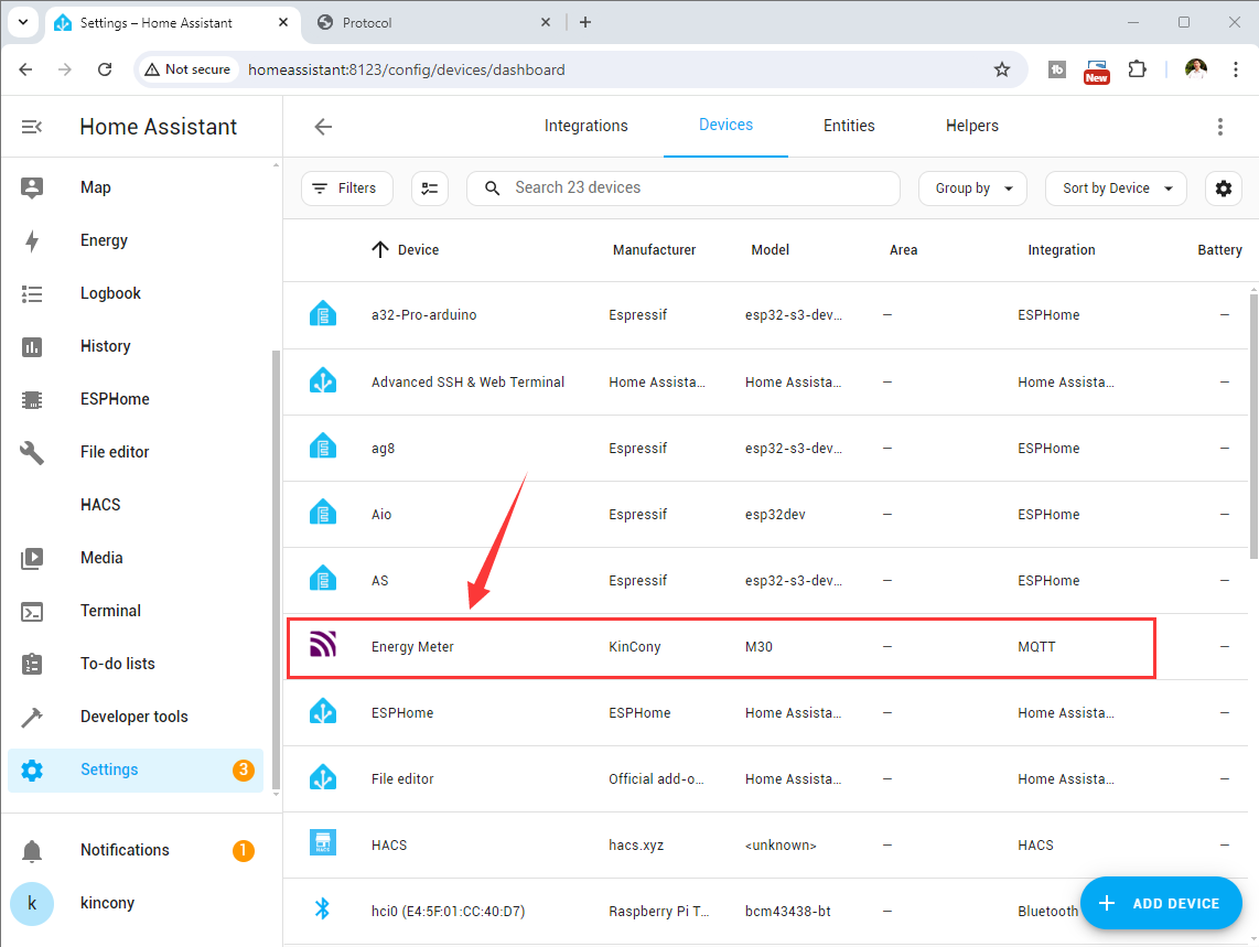

M30 can be auto discovery in home assistant.
all KinCony M30 entities use in home assistant directly.
