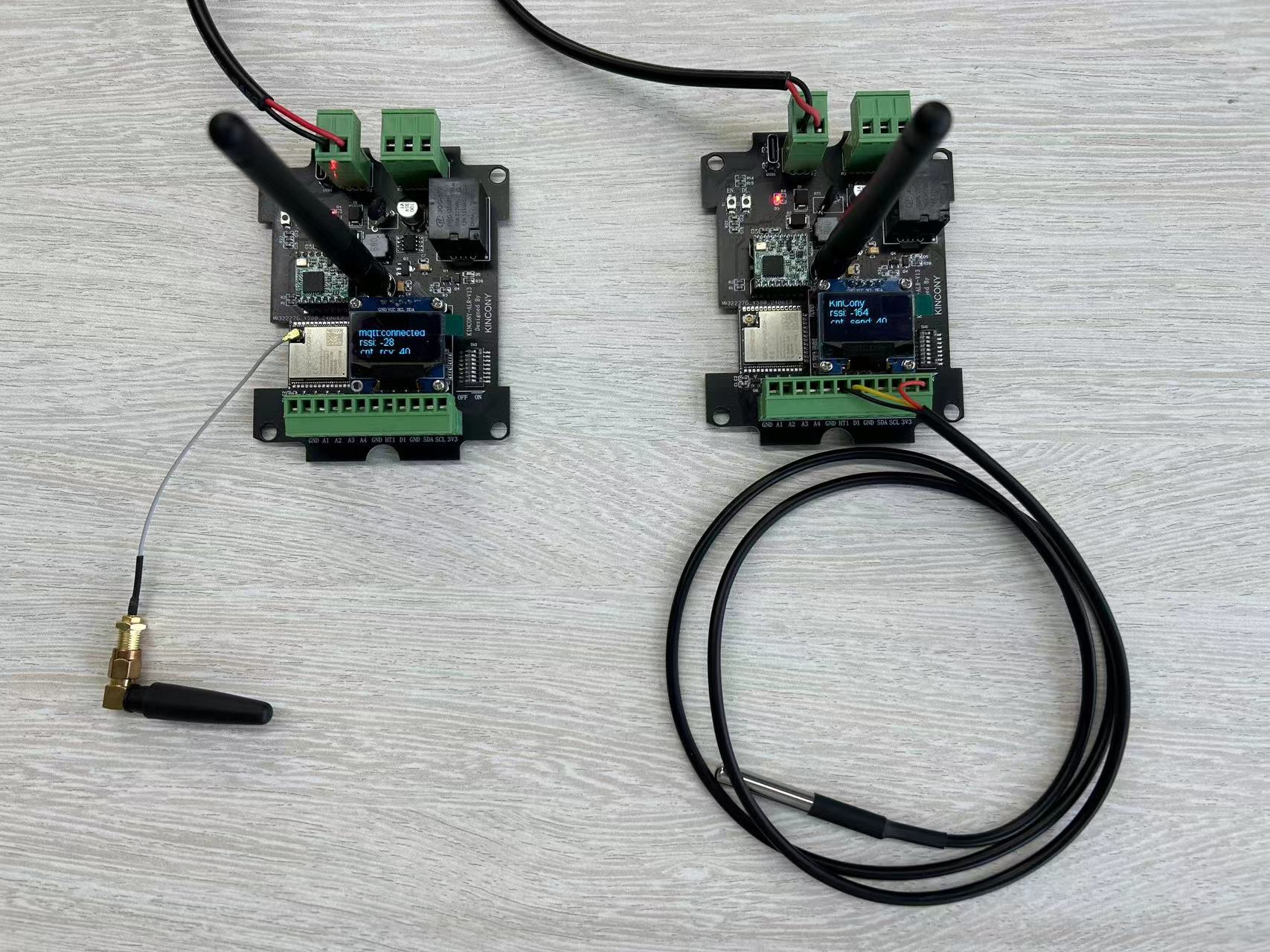

here are two ALR board. one work as RECEIVER(gateway), another work as TRANSMIT(read sensor state, control relay), just set DIP switch on PCB, let two board same DIP state, so that they will communication with each other, easy!

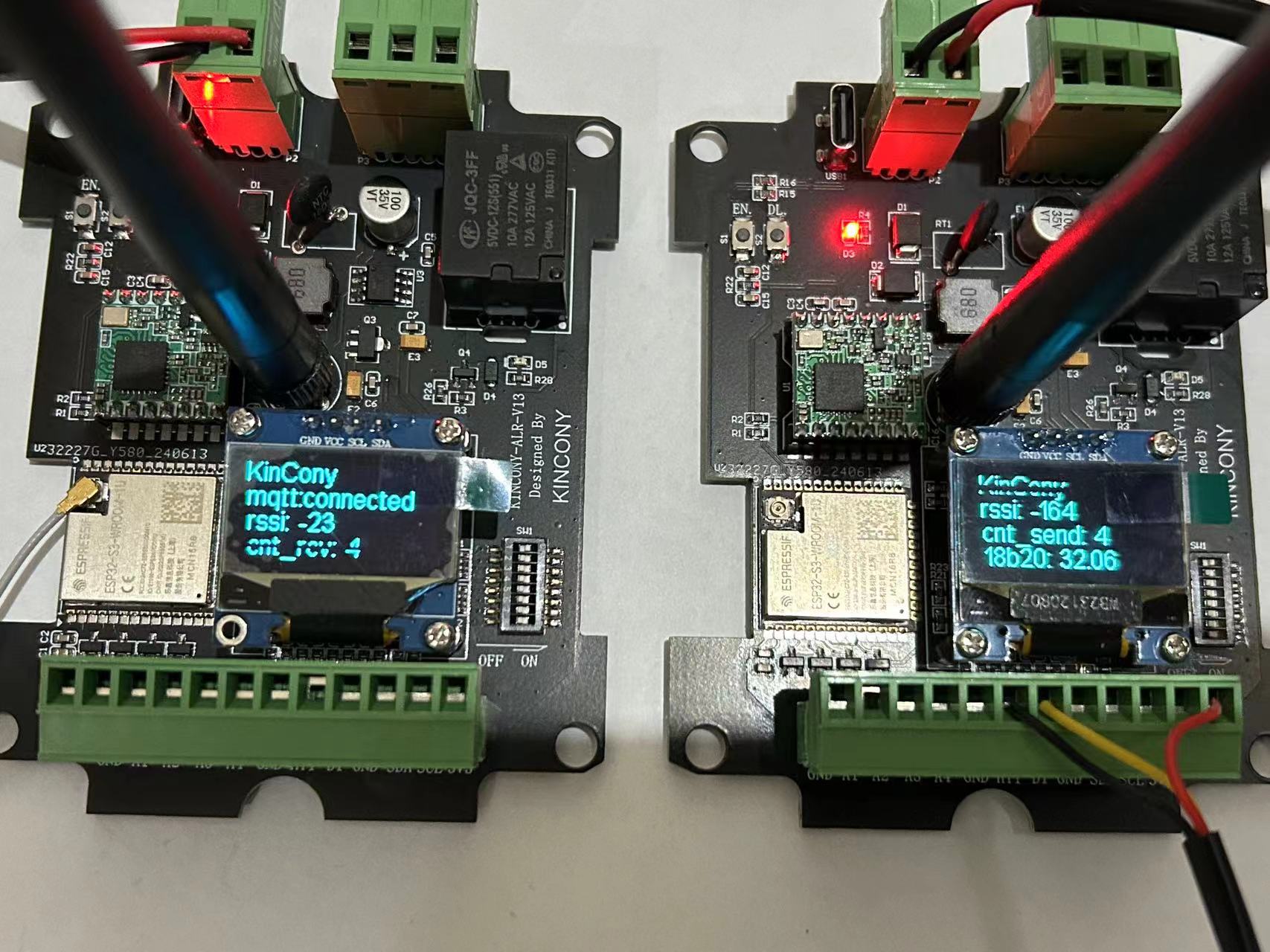

RECEIVER(gateway) board's LCD displayer will show MQTT broker connection state, LoRa signal value and how many LoRa package have received.

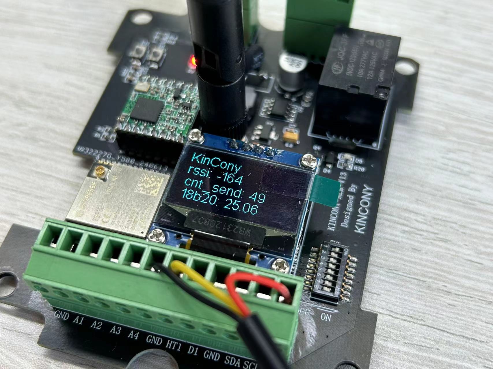

TRANSMIT board's LCD displayer will show DS18B20 temperature value, LoRa signal value and how many LoRa package have sent.

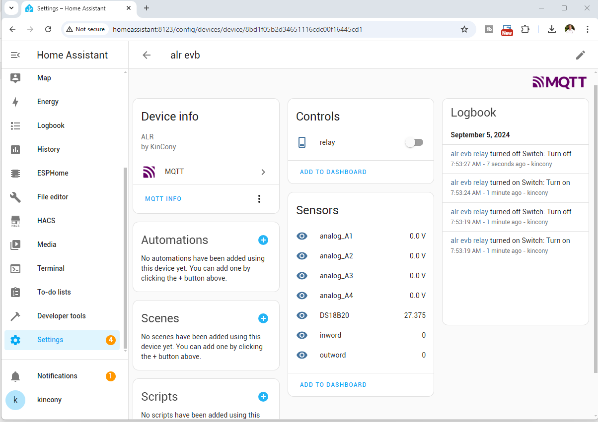

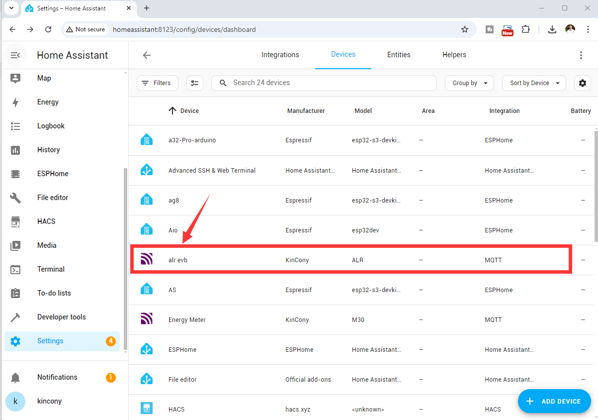

after config complete and reboot. you can see KinCony ALR board is showed on home assistant DEVICE list:
you can add these entities to home assistant dashboard.

because our firmware design for read DS18B20, so if you connect with DS18B20 as our photo, the LCD will show the value.
