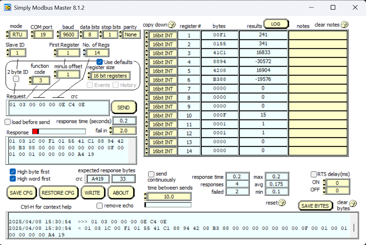

I tried changing the MODBUS address from MODBUS ID 1 to 15 on the RS-485 SHT30 temperature and relative humidity module through a function 6 write, disconnected the connector for 5 to 10 seconds, reconnected the connector, and polled the sensor over MODBUS. However, the device only responds to MODBUS ID 1, but I can see the updated MODBUS address in register 0x0a as 0x0F.
Is there another setting that has to be configured?
