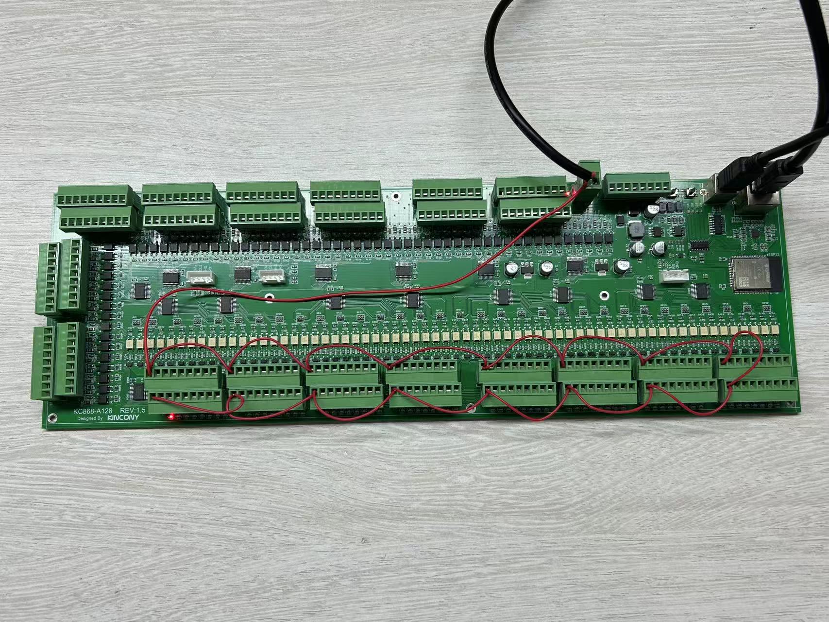

Small update
I also have an A64 board, this board does not have this problem.
Can it be the ESP32 chip that breaks i am going to check the voltage input but it must be fine 24v 25A power supply
also can you test the with wifi
ok, i will test with wifi by esphome.
Tested with KC868-A128. here are two yaml file for ethernet and wifi.
.txt   KC868-A128-HA-Ethernet.txt (Size: 40.61 KB / Downloads: 387)
.txt   KC868-A128-HA-Wifi.txt (Size: 40.67 KB / Downloads: 352)
So the esp32 a64 card is stable but the a128 card not can this be a failing esp32
I am going to swap the eth cable
Also i am checking the imput voltage
So update wifi is stable but lan not problem with ethernet chip??

ethernet not stable?
