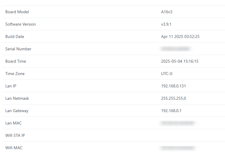

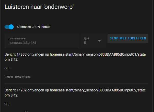

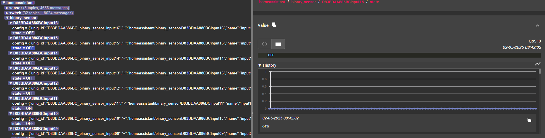

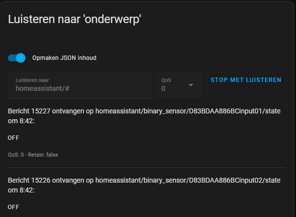

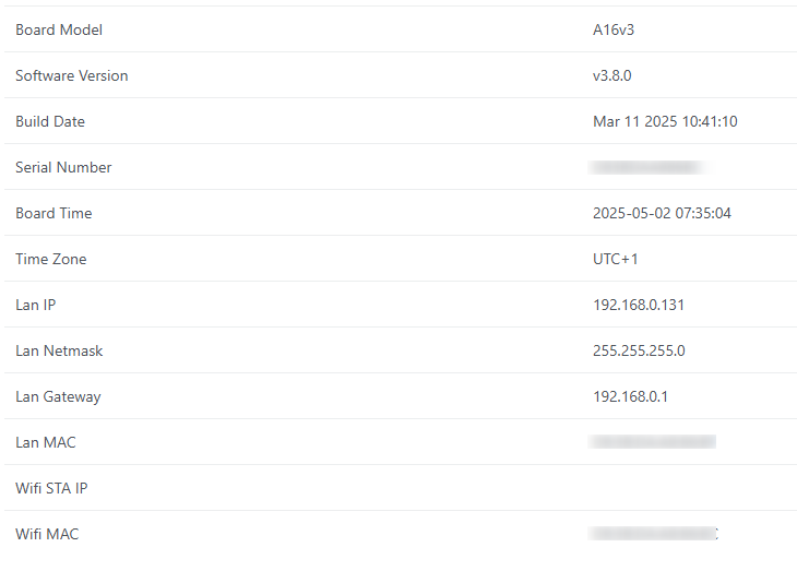

I uploaded multiple screenshots. One of my firmware version, second mqtt explorer (you see a lot of messages and I just started it 20min ago ...) and last ones are 2 screenshots of home assistant broker who is listening to all incoming messages.
Did I miss a firmware version here?

can you test with newest verison v3.9.1 : https://www.kincony.com/forum/showthread.php?tid=7931
(05-03-2025, 07:55 AM)admin Wrote: can you test with newest verison v3.9.1 : https://www.kincony.com/forum/showthread.php?tid=7931
Sorry, I'm afraid it's the same with v.3.9.1.
