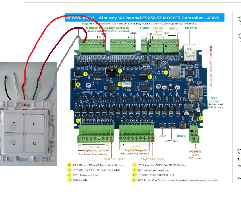

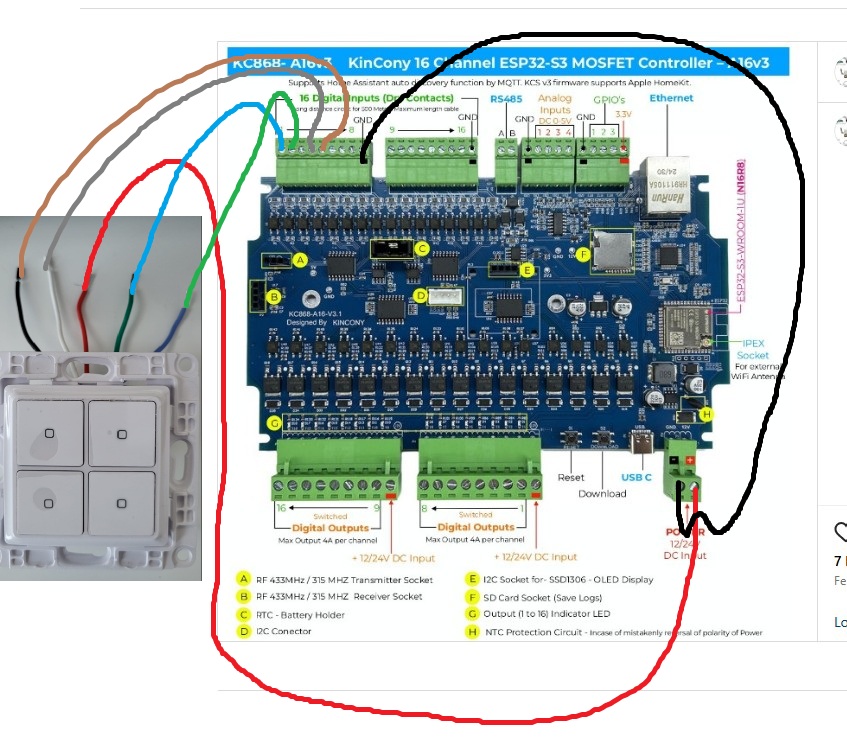

take a photo how you connect with each device.

Posts: 10,450

what's your 4 gang switch every wire define?
the common line should connect to KC868-A16v3's GND. others cable just connect with different digital input ports. switch not need any power.
after connected with wire, you need set by IFTTT, let digital input TOGGLE digital output ports. make sure you have downloaded KCS v3 firmware by USB-C cable, because of new pcb no firmware inside of ESP32S3.

Perfect. Now it works just by using the gnd connection and configuring IFTTT for the inputs and outputs toggle. Really appreciate your help.
If I have multiple switches cand I use the same GND to have control on the inputs?
If I have multiple switches cand I use the same GND to have control on the inputs? does it also work with regular switches (i mean classic ones that only require 1 wire just to switch the line)
Posts: 10,450
Threads: 1,559
258
1. YES, if use multi switch, just use same one GND is ok.
2. digital input support connect with "regular switches", just need config by IFTTT.
