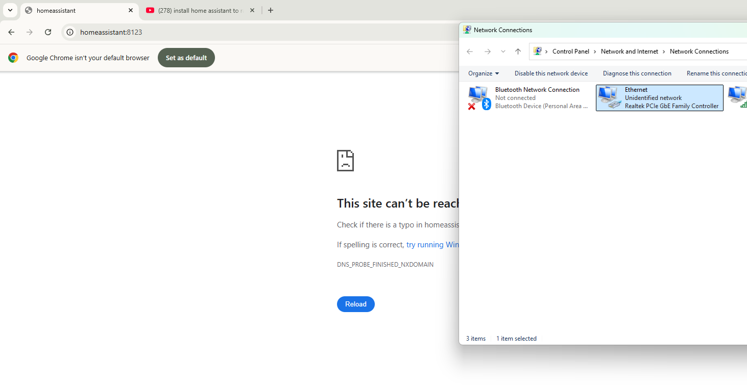

i want to install home assistant using LAN connector but when i type http://homeassistant:8123/ nothing happen
my ethernet already connected but still unidentified network
can someone help me?
your server16 and your computer connect to same router. not use ethernet cable connect to your computer directly.
(07-04-2025, 05:39 AM)admin Wrote: your server16 and your computer connect to same router. not use ethernet cable connect to your computer directly.
and how long i must reload the page ?

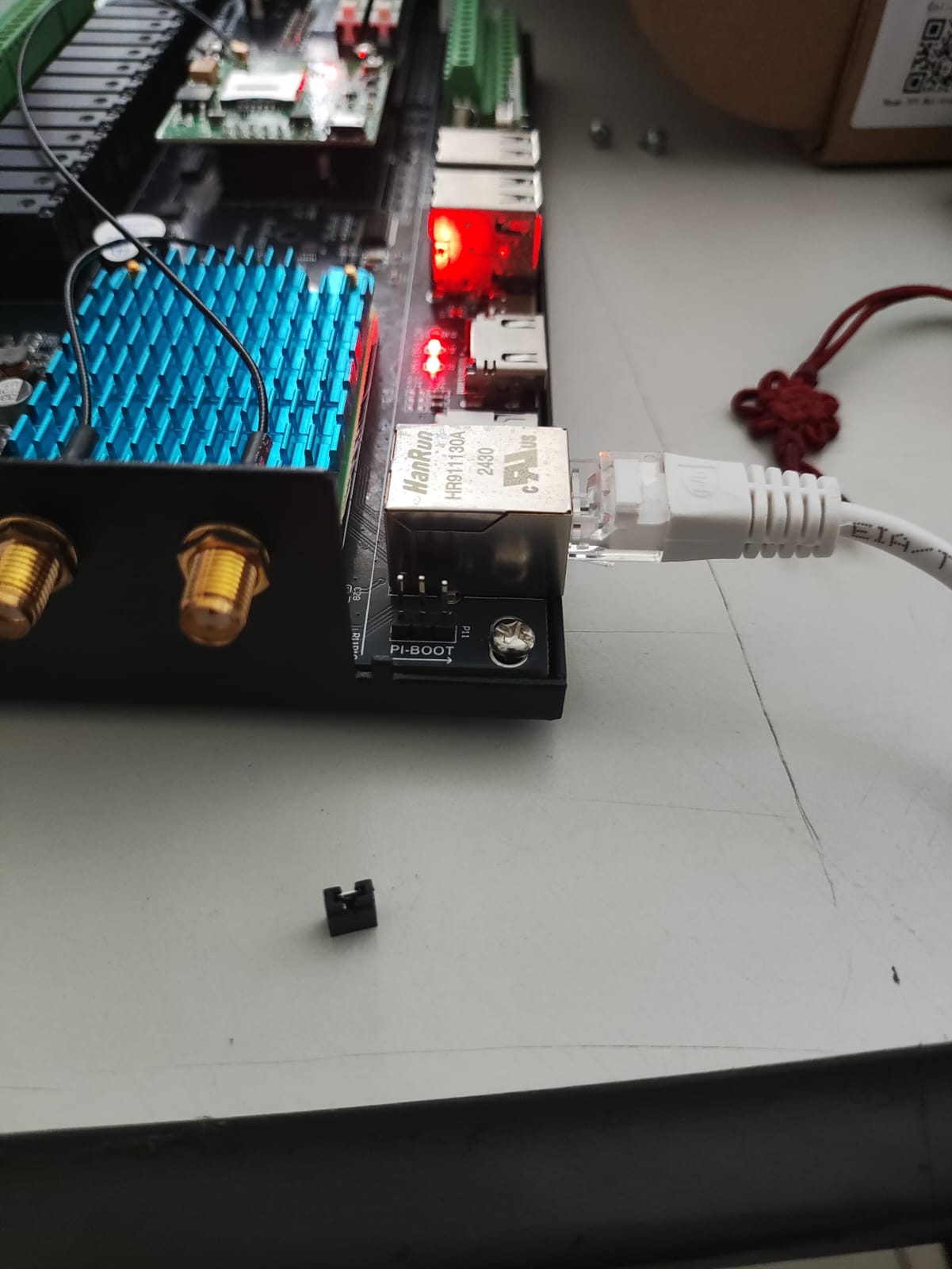

I remove this, does it have any effect?
do you have used pi image tool downloaded home assistant firmware?
(07-05-2025, 01:40 AM)admin Wrote: do you have used pi image tool downloaded home assistant firmware?
i do
after download home assistant, login by your router, check your server16's ip. then use http://ip:8123 to login, not use by domain name.
(07-07-2025, 10:49 PM)admin Wrote: after download home assistant, login by your router, check your server16's ip. then use http://ip:8123 to login, not use by domain name.
took too long to respond.
refused to connect.
