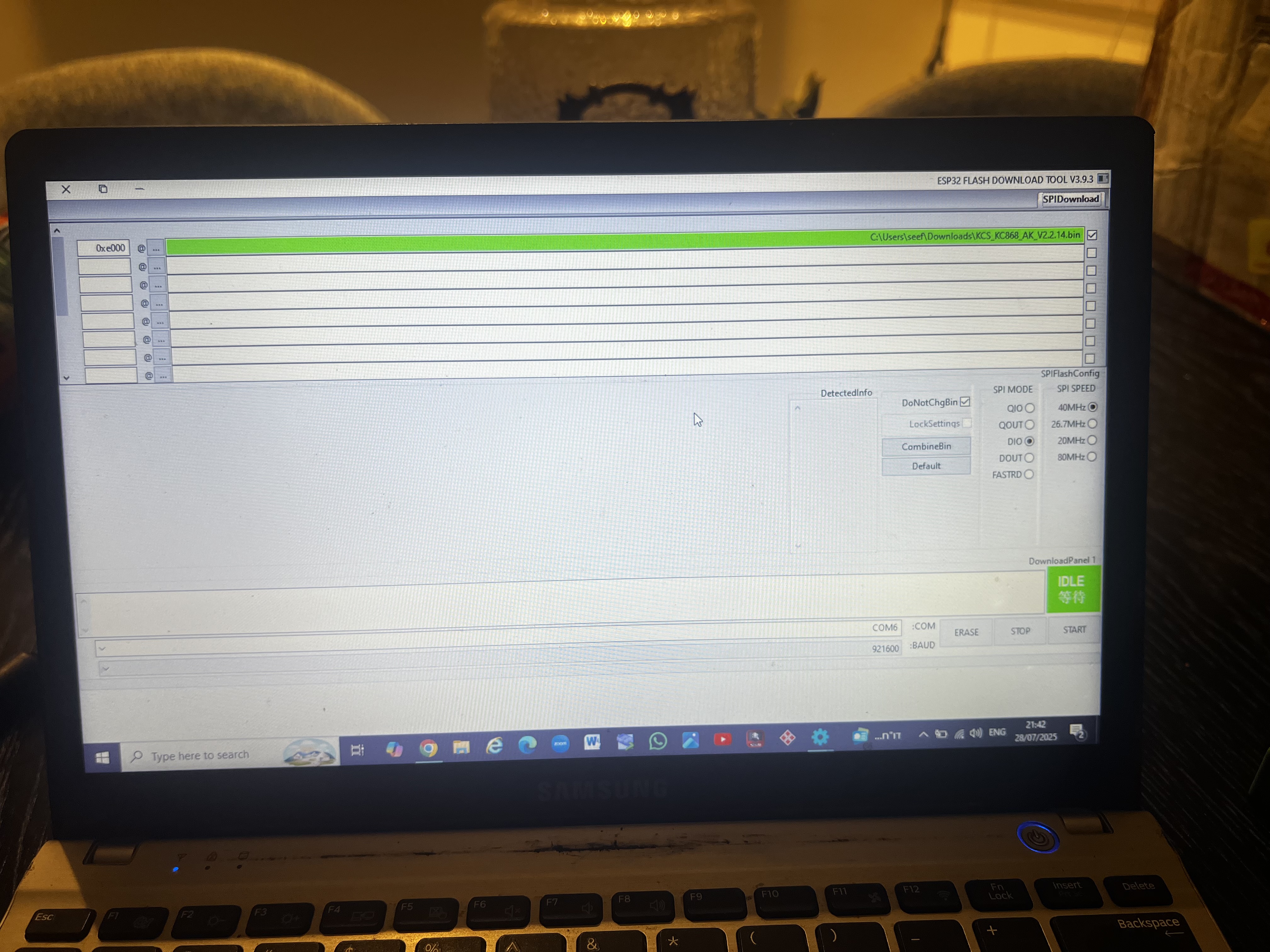

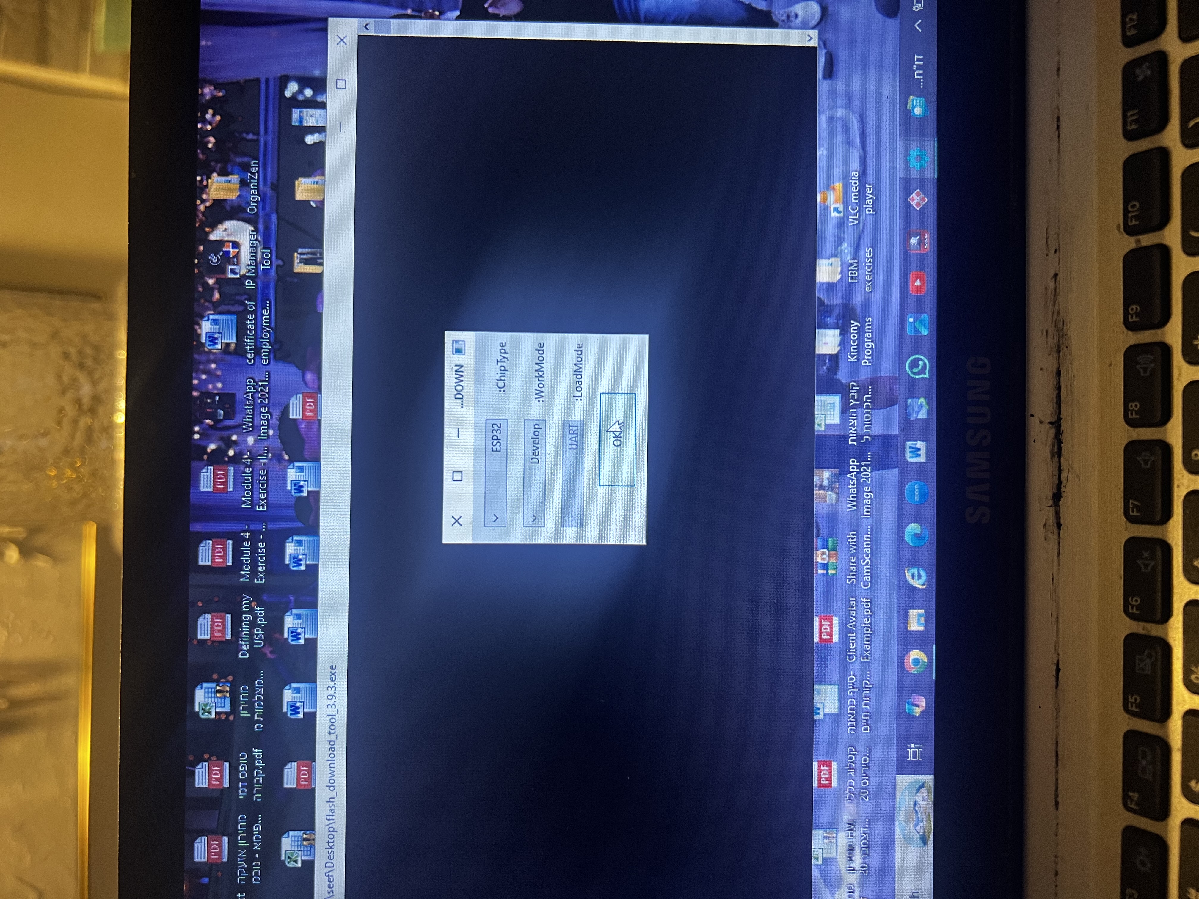

I downloaded the kcs v.2.2.14 firmware, and after that no response from AK board. I can’t see AK wifi to connect to it by PC.
I’m trying to press download one click to enable wifi-AP, but no response,the D2 LED doesn’t turn on. I’m trying to reset the board by pressing reset>10sec , also no response!!! I don’t see that D1 fast blink. All that happened after trying to download kcs v 2.2.14. Before that, it worked well and i was able to enable AP-wifi and connect to the board
download address is wrong. you have set 0xe000. it should be 0x0
here is KCS v2 online guide: https://www.kincony.com/esp32-kcsv2-firmware.html
07-29-2025, 02:29 PM
great, now it's working. thanks.
