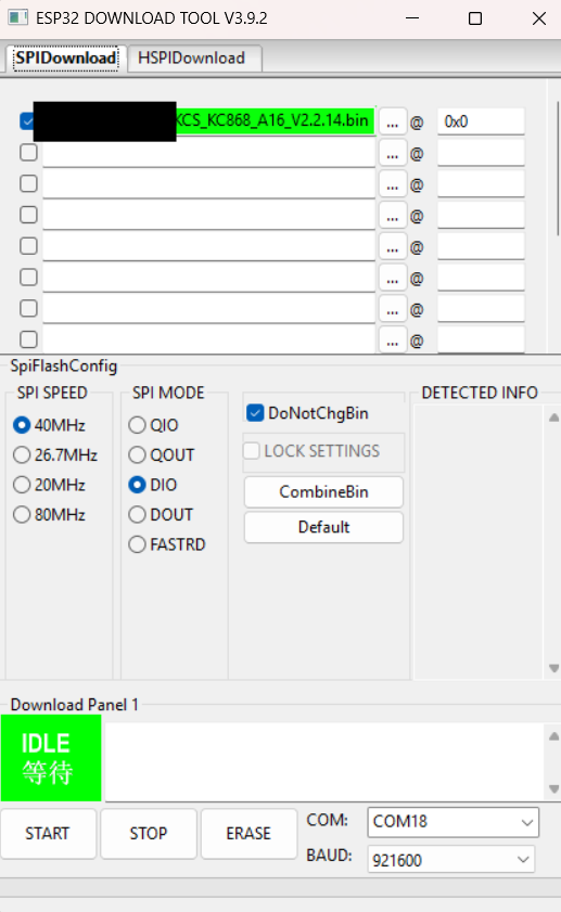

take photo of your setting of ESP download tool i want to see how you download KCS v2 firmware.
(08-05-2025, 11:10 PM)admin Wrote: take photo of your setting of ESP download tool i want to see how you download KCS v2 firmware.
Here, and it finishes successfully. There is no AP from the board after download.
after downloaded firmware, MUST re power on of your board. then use ethernet cable firstly, login by web browser, set the wifi to STA mode, input your router's ssid and password.
